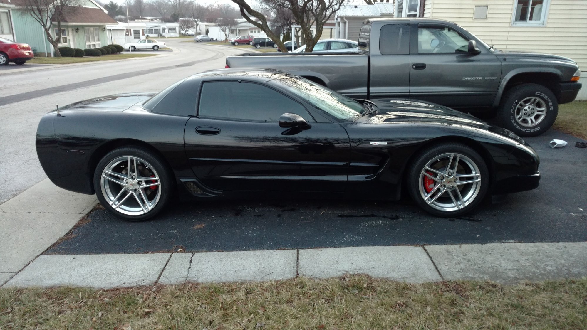

Originally Posted by SG Lou
Yes I'm putting OEM C6 Polished 5 Spokes on my 04.
I LOVE them and that's that !
I have done the search, read MANY threads and I'm not coming up with a conclusive, final, definitive answer.
According to charts I have seen, things I have read, the stock C5 Wheel offset is +58 mm in the front, +65 mm in the rear.
Stock C6 wheels are +56 mm in the front, +79 mm in the rear.
So if my calculations are correct, the front wheels are basically a straight swap. Ok, they are off by 2 mm, no big deal.
The rear wheels have a difference of 14 mm. ( 79-65 =14 )
Yet I'm seeing and reading about adapter width's anywhere from 20 mm ( 3/4") to 25 mm ( 1") being used in the rear.
Am I missing something here ?
What width adapter will I need to bring the rear tires out flush with the rear fender ?
1/8 in 3mm on my 2002 Z06 OEM C6 Z06 Wheels and tires must remove rear air ducts
