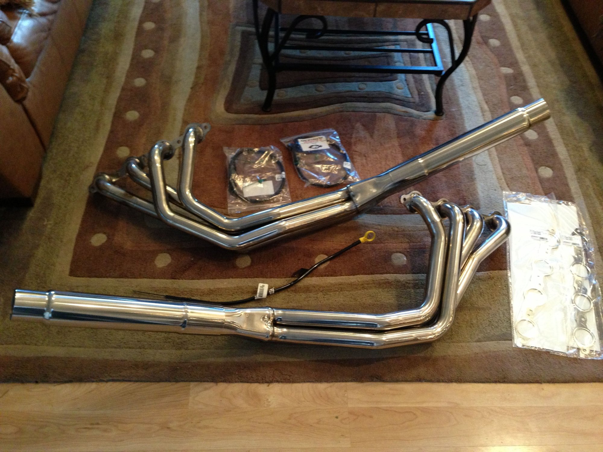

$450 is an excellent price for headers. But the ones under discussion (http://www.texas-speed.com/p-708-tsp...-corvette.aspx) specifically come with OFF ROAD adapters that connect to the stock H pipe. You have to cut off the front part of the stock exhaust, including the stock cats.
As a matter of fact, they are the same headers I have on my Vette.
This is the headers with adapters in place. As you can see, the "off road adapters" clearly extend beyond the rear of the cats.
With my original engine, I did not use their adapters. Instead, I attached a pair of Random Technologies high flow cats (which are most definitely NOT in the stock location) and then made pipe to connect to the stock H pipe. That engine with CAI, that exhaust, and a tune made 335/344 at the wheels.
Long tube headers cannot be used on these cars without relocating or removing the cats. If you want to remain within the letter of the law, you have to use shorties or mid-length headers.
Those can work very well. I had a set of MAC mid-length headers and Y pipe on a blown/stroked '95 TA and put down about 575 to the wheels while remaining 100% legal.
