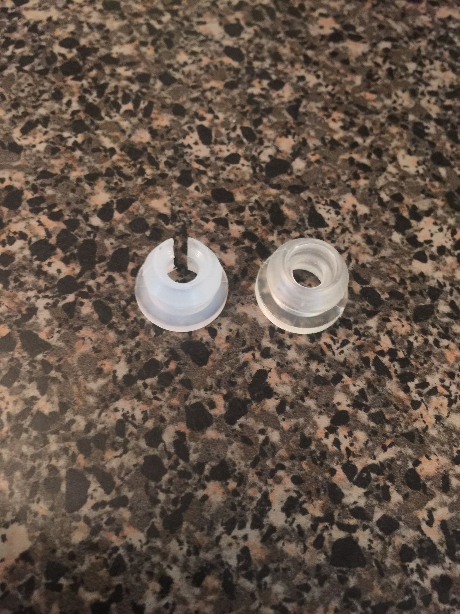

Buy the ones that have a notch in them. The solid ones are damn near impossible to snap in place with the little room available to work in. I learned the hard way cutting up hands struggling to pop that into the insert. The ones with a notch snap right in easy the first time.....Good luck....🍺🍺

The front bushing in my ‘04 broke at about 110,000 miles. I replaced the bushing with the aftermarket part but destroyed the cable in the process. Had to have the dealer replace cable. Ugh!

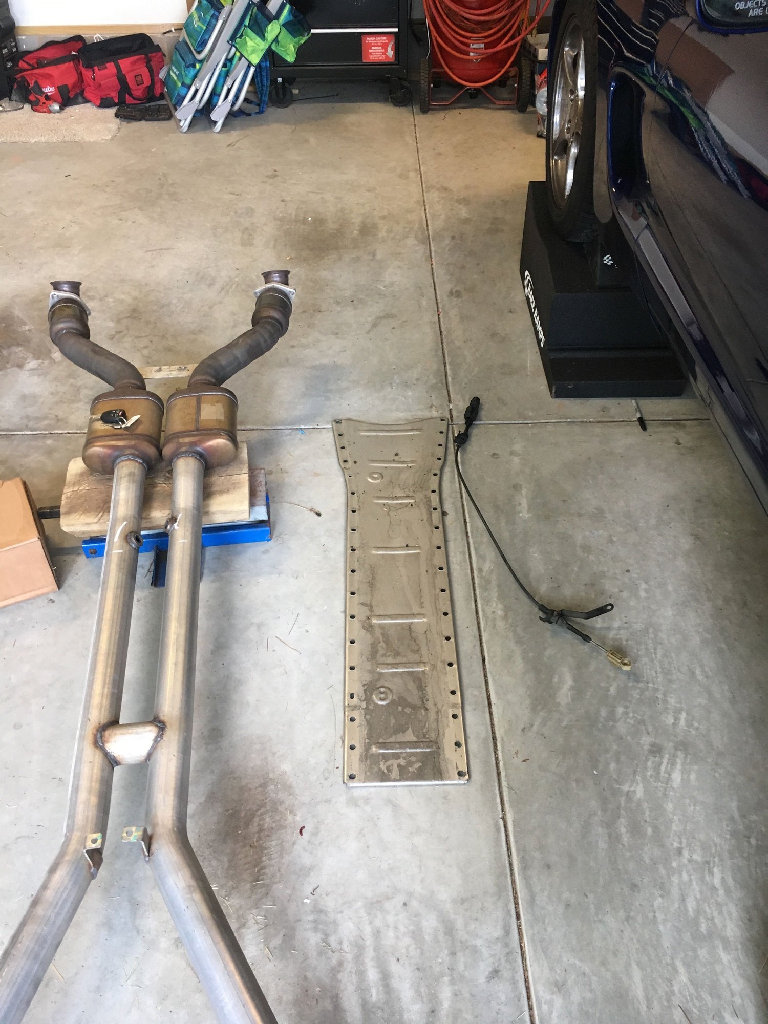

Been there, done that, got the t-shirt. The cables get sooo brittle by the shifter from the heat from the cats and exhaust, my firm recommendation is just replace the cable. The slightest deflection at the shifter end and they break. I also did an insulated tunnel plate at the same time (not shown). Heat in cabin huge decrease.

if it’s the bushing you can get a pack for like $5-$10 and it’s really simple to change out your self on both the front bushing and rear bushing. The front you’ll have to remove your center console trim and remove your shifter and the cables right under it by the trans tunnel/tourqe pole just make sure you remount it correctly on the inside bracket so it has enough tension to shift gears. The rear one is connected to the driver side of the trans pan and it’s just a matter of jacking up the car and popping the cable off if it’s not already off.
for the cable it self it’s a bit trickier but doable to. You have to remove the center part of the exhaust and the tourqe cover above it and run the cable line up to the the front then to the rear behind the trans pan and on the metal tip
this is just my advice i have a 2003 c5 that bushing just cracked from being old, if one of the bushing goes out from being old I’d recommend replacing the second bushing weather is rear or front cause it’s just a matter of time before it goes out.
