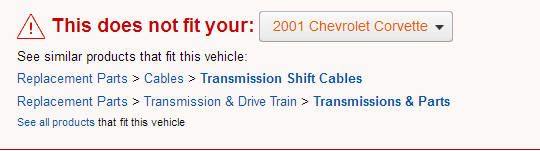

Originally Posted by sloopdawg
Is there a site or number that works?
This says its not for a c5
Just go to Autozone. In the Help section there is a package with 4 of 5 of those bushings. One of them fits. I think the second to smallest one. Costs about $5. Dorman 14041. I know it says it does not fit , but it does.
