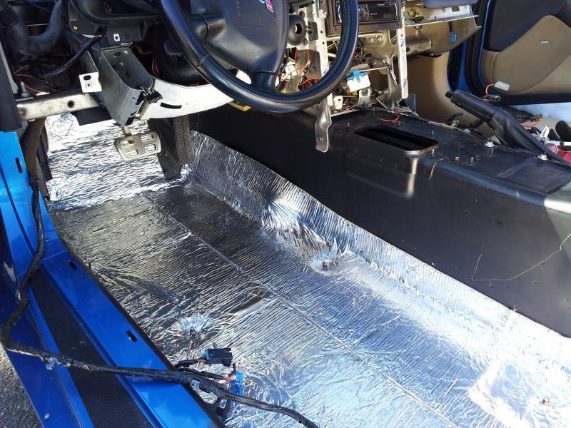

Ya got to be a little more specific then that but i think I know where your going with this. You can go the traditional route and purchase Dyna Mat but it's expensive and heavy and it weighs the car down. A lot of guys go to Home Depot or Lowes and purchase a few rolls of Frost King Duct Insulation. It's a 1/8" thick dense foam that's foil lined and it's self adhesive. You remove your carpeting and line int the trunk area with this stuff, cutting and fitting it properly. Re install your carpeting and your good to go. And......if you have gone that far you might as well gut the entire interior and install it all over. It will reduce not only road noise but will keep the cockpit cooler, especially in the Trans tunnel area where it get really hot.

I used Fat Mat from Amazon, it has gone up in price since I did mine but way thicker than Dyno Mat !!! Have to use a hair dryer or heat gun !!!
Amazon Amazon
(it has doubled in price since I bought)
