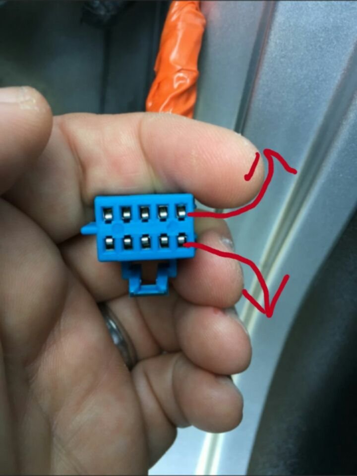

here is a pic of my plug. The connections look ok but can someone confirm from their perspective if I should try bending them to firm them up?

That should be the direction to bend them. Get a dental pick or something similar and get it behind the part that looks kinda rolled over. The five on each side bend the same way. They bend pretty easy so do get crazy with it. Just get the pick in and pull down alittle.

Thanks 8vette7 for clearing that up and the pics. I haven't been in mine for awhile and didn't even remember there was a black plug.

Originally Posted by 8VETTE7
The BLUE connector is NOT the cause of your symptoms.......
The BLACK connector has the appearance of the Serial Data Buss which causes your symptoms when the connections are not good.
The blue connector has Audio related wiring and the automatic day/night mirror wiring:
Blue Connector
Attachment 48117568
Black Connector
Attachment 48117567
well now I'm very confused because the blue plug is the one I pulled apart and messed with the pins and reassembled. Afterward everything worked and the error codes cleared and did not return. Perhaps it's coincidental. I'll wait to see if I get the issues again and then try the other plug. Perhaps moving things around temporarily fixed the black serial plug......
