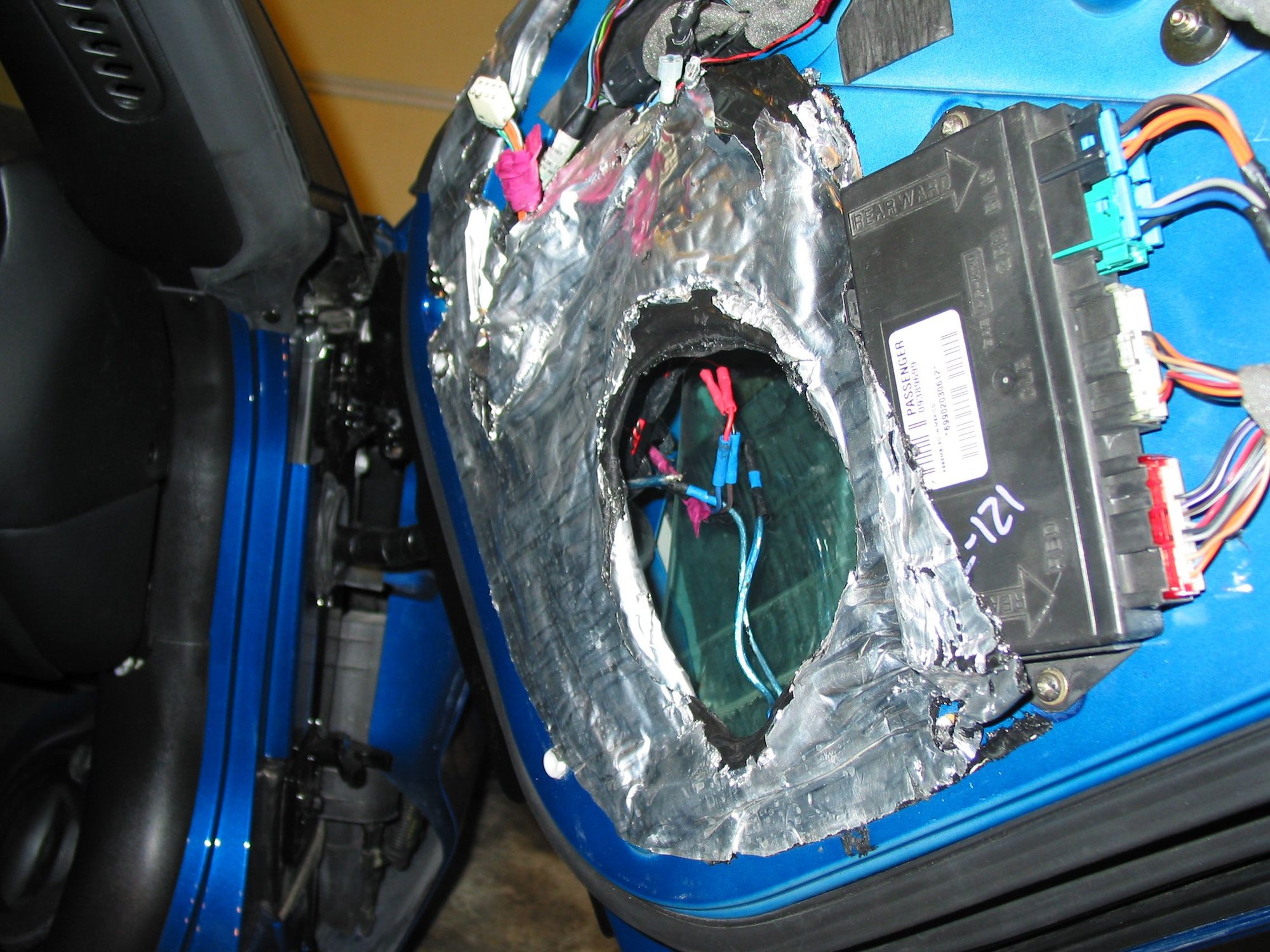

There is a connector in the door's rubber boot, if it came loose, nothing will work from (or into) the door. Though, if your door buttons still light up it's not the connector but probably the doors control module which is in the door itself.
Here is a picture of one.
