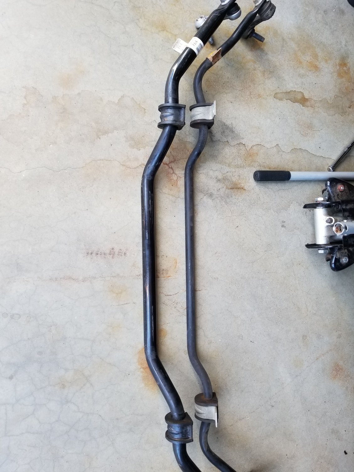

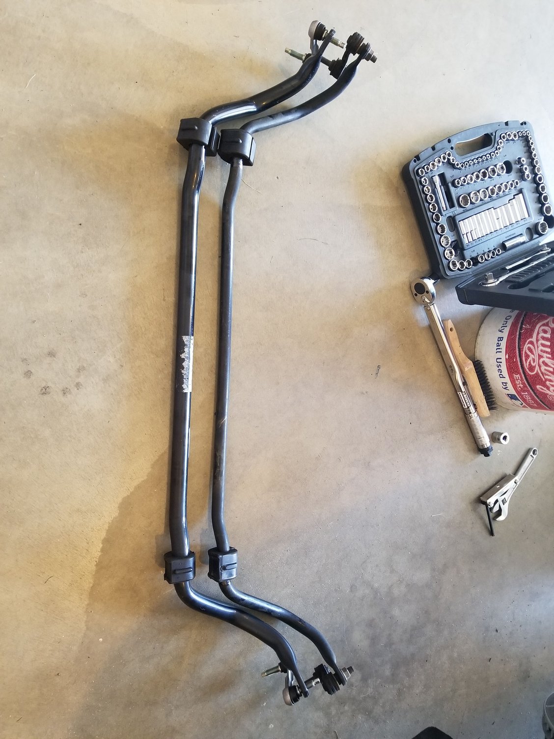

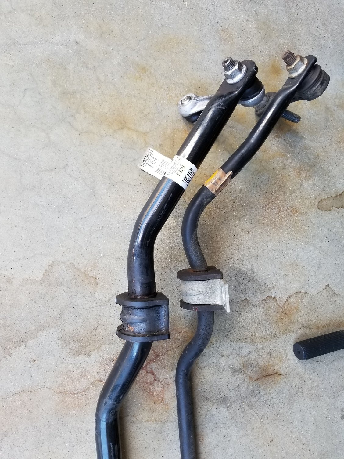

All is good once again. Thanks to CF member Steve Doten for hooking me up with a pair of bolts and washers. Also for the upgraded sway bars and end links!
I ended up getting some blue loc-tite and a torque wrench. I removed all caliper bolts amd the brackets bolts, wire brushed them, applied loc-tite and torqued to spec. Good thing too, because ALL my caliper bolts were about finger tight!!!
Since I had the front then rear on stands, and the wheels off, I decided to change out the sway bars and end links while I was there. Big difference in size!
