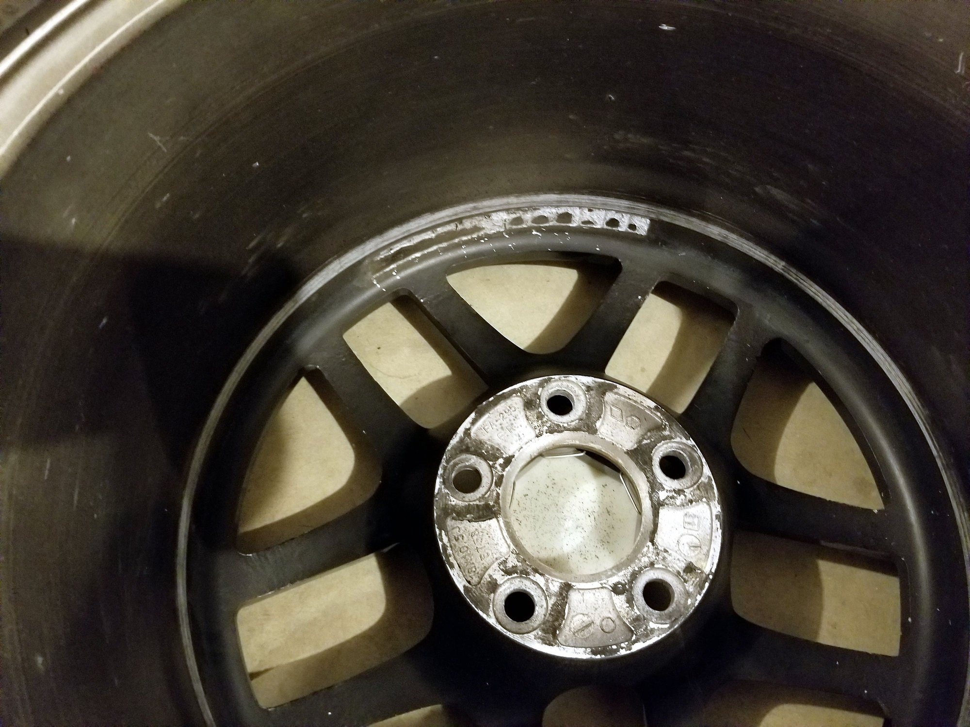

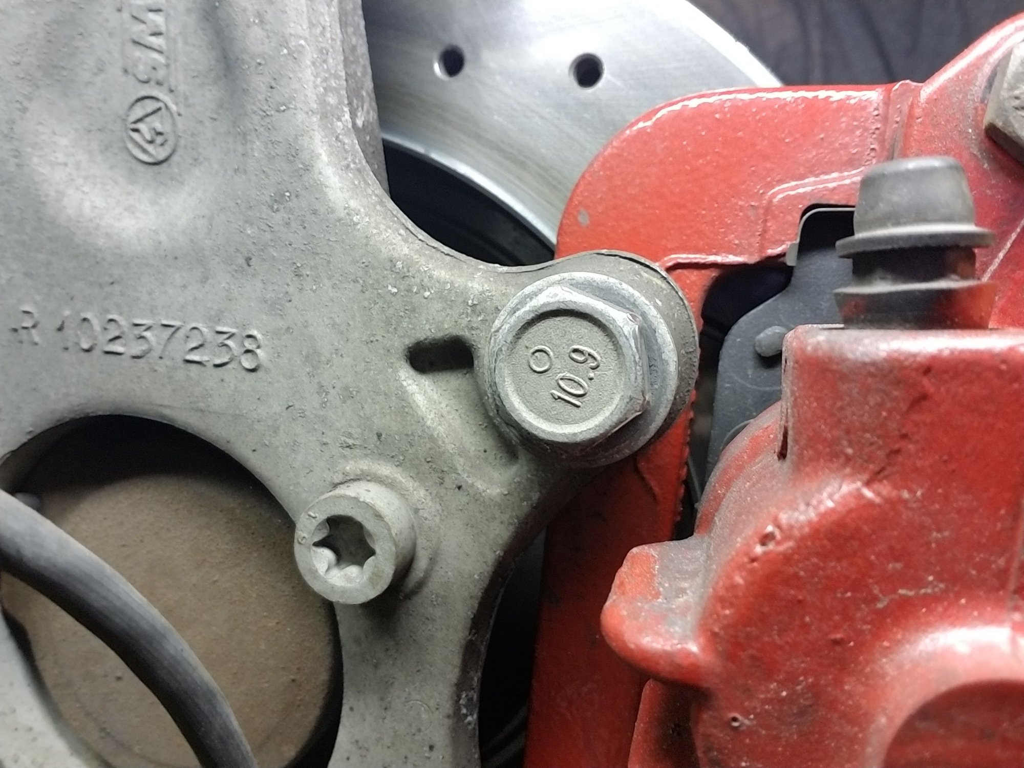

Ok boys and girls, learn from my mistake. When a bolt calls for loc-tite, USE it! I dodged a major problem which could have resulted in a nasty crash and/or major repairs! I was extremely lucky!

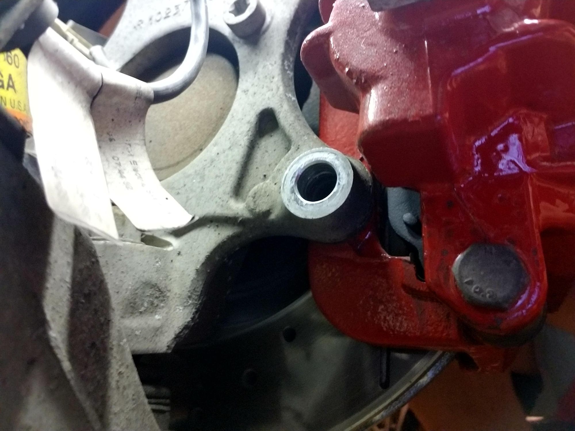

Driving home yesterday from a Corvette meet in RI, exiting the expressway, when i applied my brakes, I heard an awkward sound, clunking, slamming, etc. I looked around, saw nothing (expected to see something behind me that I might have run over). Applied the brakes again, LOUDER noises and now I saw little parts go flying from the right front corner. I instantly thought,.... lug nuts!!! I pulled over and stopped right away. All lugs are in place. No visable signs of anything wrong, missing, broken, anything. Until I saw what looked like my caliper a little too close to the wheel. I grabbed a lug wrench I had in the trunk (recently had the wheels off to lower the car) and used the end to actually move the caliper!!!! It would appear the lower caliper bolt was either broken or gone. I limped home, down shifting as much as I could (its an auto so....). Got home and parked the car in the garage. Waited until today to see exactly what happened.
Tonight, when looking into what happened to my brakes, the lower caliper bolt was gone. Not broken, not anything but it was worked loose, and fell out! Turns out, what I saw flying were all the wheel weights from the inside of the wheel. The caliper looked like it gouged the barrel, but it only scratched some of the paint. After about 2000 miles, it was enough to vibrate its way out, then off.
I don't care how much of a PIA it is to remove something with loc-tite, I'll muscle my way through it, again.
DON'T CUT CORNERS, DON'T TAKE THE EASY WAY. Do it right, or don't do it at all.
I'll get another bolt, some blue loc-tite, and redo all the caliper bolts. Lucky, and lesson learned!
