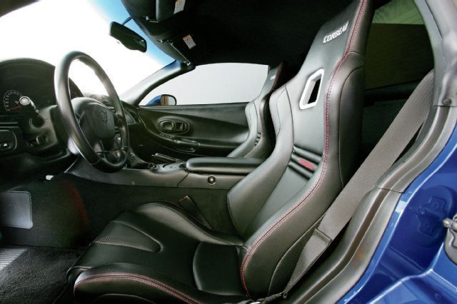

Honestly, I think the Corbeau EVO's look pretty decent and not too out of place in a C5. Reasonably priced too.
http://www.superchevy.com/how-to/int...ution-x-seats/
