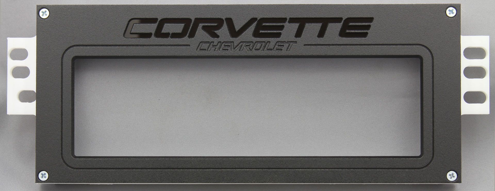

A double DIN is very nice, but if budget doesn't allow it and you want to consider a single DIN, then you would need an adapter plate to secure the new unit in place and provide a nice finish.
Here is an adapter plate that matches the interior very well. It has the word "Corvette" engraved in it that can be set up with backlighting (or you can customize the lettering).
From their website:

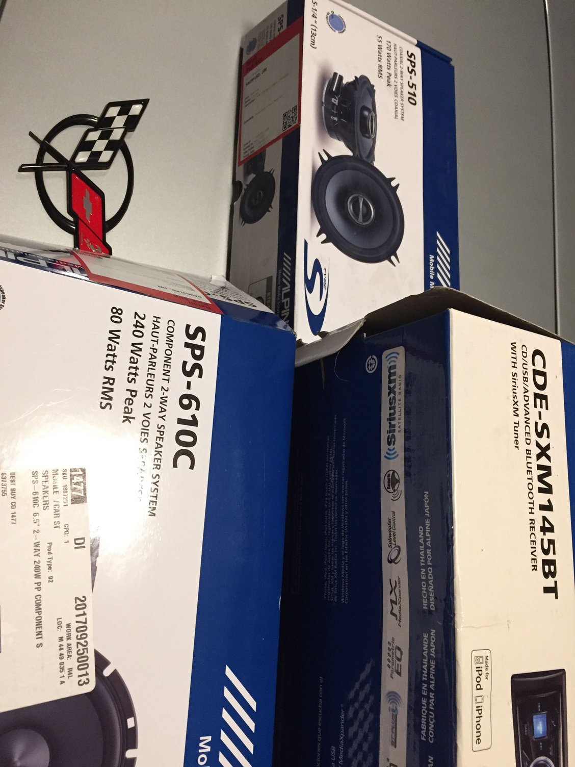

Originally Posted by cvitullo
Ok - thanks for the tip on the adapter
Alpine! I researched and went with Alpine head unit and 4 alpine speakers and an amp. Amazing upgrade.
