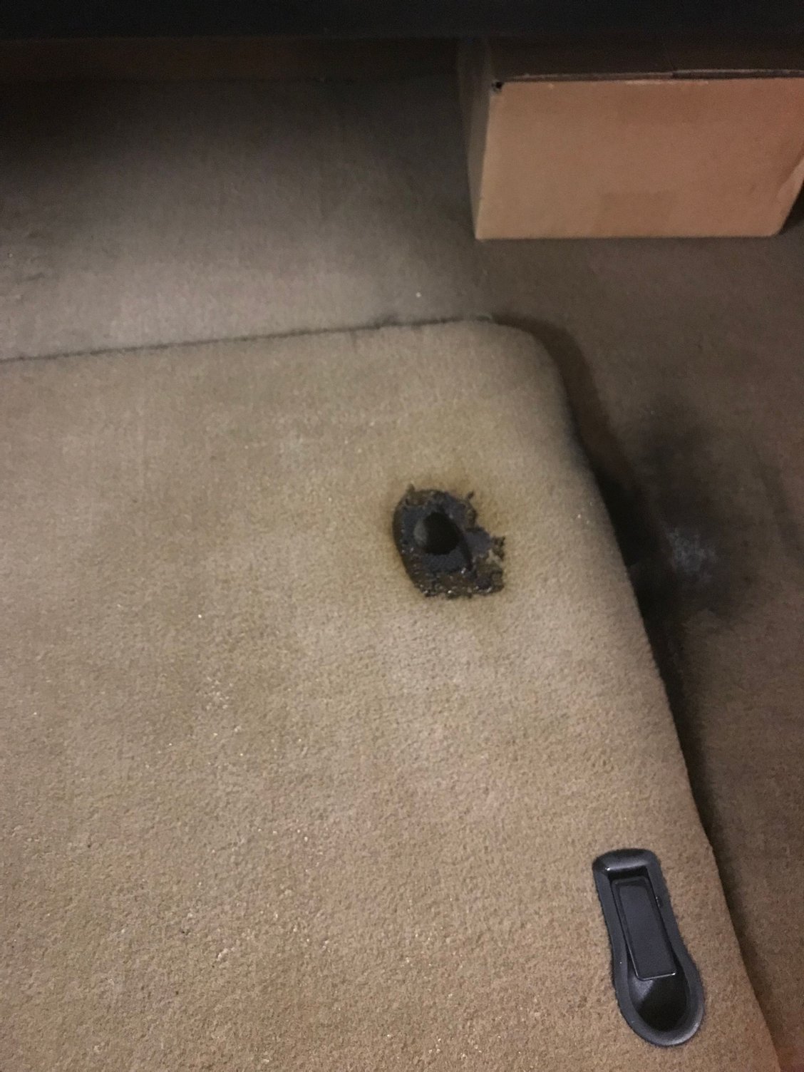

So while having a bit of fun with a really fast crotch rocket (he pretty much smoked me, quite literally) I kept up for a bit but both of us have really quick acceleration and hit way to high of speeds to stay in it very long. It worked out to be three or four lights. After the last pull I started to smell plastic burning, I thought it may be a wire or something up against the headers. I pulled over and checked under the hood and found nothing but I started to see smoke coming from in car towards back looked under car and saw nothing??? Then I opened the trunk and saw this ........
I say lucky because I happened to have water in my trunk, I went out to get distilled water for my fish tank, it blew a hose off and leaked a bunch of water out and I did not have enough R.O. water to fill it back up, so off to the store I went. It was a good excuse to drive my car I just got back. Any how is this very common?

Wow! Glad you found it before more burned! Do you know what caused it?

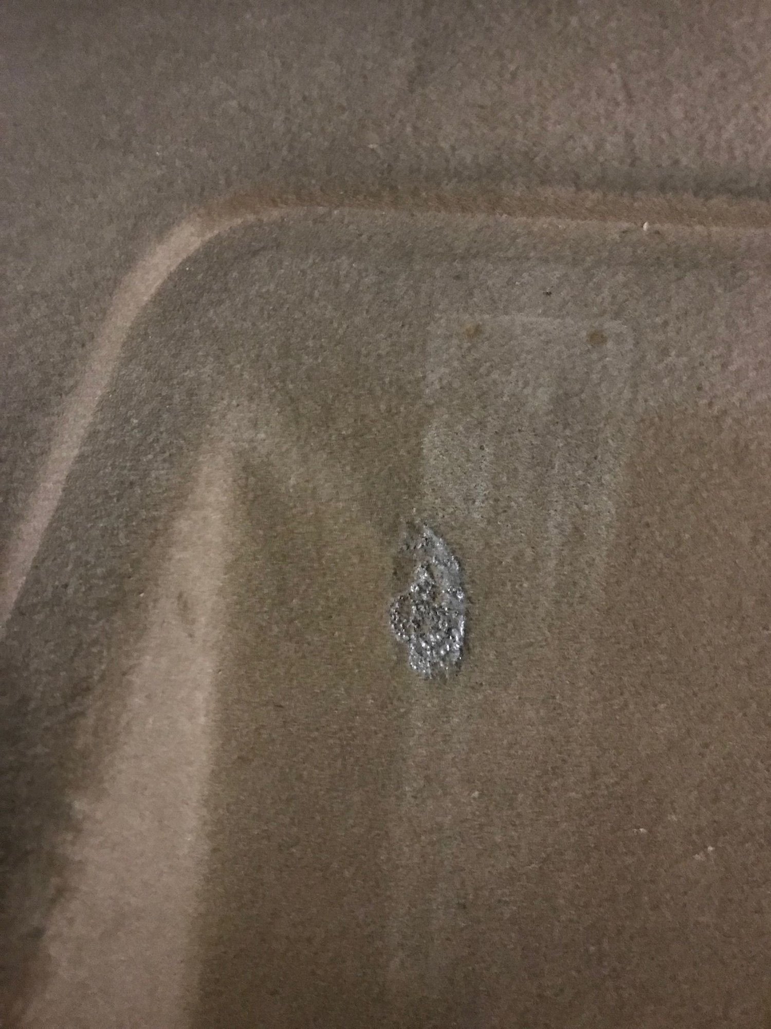

The axle back exhaust too close to floor?
Other side just starting.....

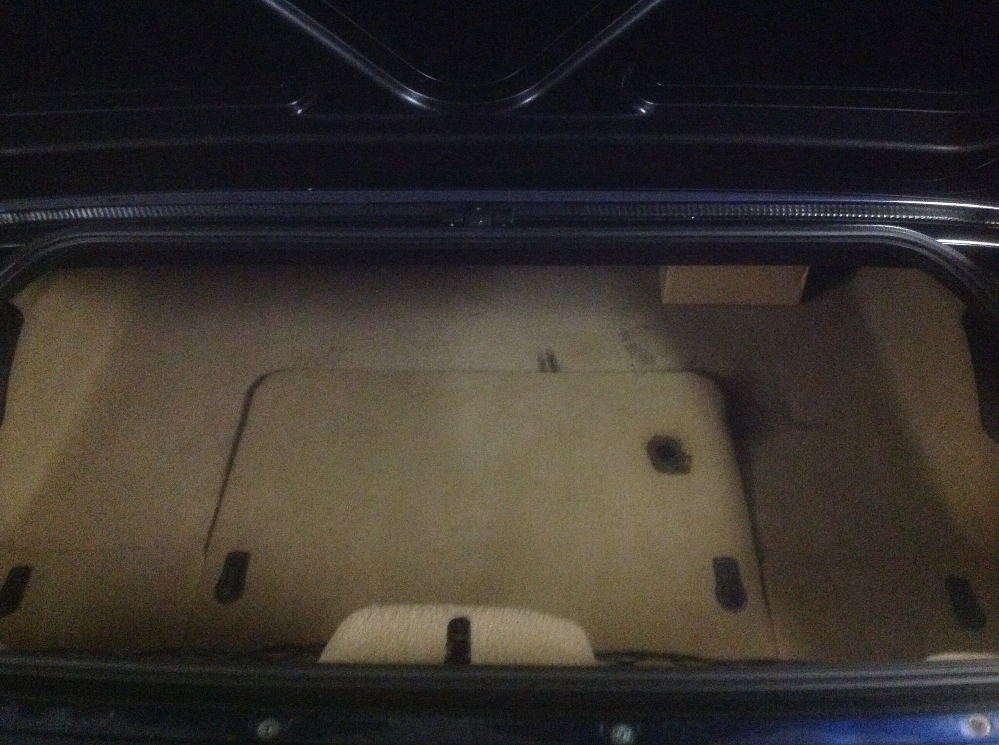

What is your exhaust setup?
My SLP mufflers have singed the bottom of my rear bumper way up under where it's not noticeable. I've been meaning to put a fire extinguisher in my Corvette, and now I will definitely be doing so, maybe more than 1. I put aluminum HVAC tape over the edges of my bumper where it's close to the exhaust. It's the same stuff we use in race cars to seal up holes in the pans when the interior is ripped out.
Can you get a zoomed out picture, so I can understand this location better to look at mine?
Top front corners of both sides of well.....

Factory Ti's? Something else must have caused that fire like an exhaust leak with flames coming out. Maybe some hot brake pad material.

Nope......I know exactly where it is under car, it is right where exhaust comes over axle, must be a issue with install, just got car back from shop the whole tt and rear cradle was out. There is no exhaust connection there.

No, I hate to admit this, but I saw some marks when it was up on the lift, they were looking for some knocking noises and found the exhaust was hitting trans and a bolt on that side. I asked about the marks and was told it was common to see those marks. The shop owner was not there so, I trusted his guys.......obviously there were mistaken.

It was on fire, there were flames, carpet was burning under cargo well cover....... It was the exhaust for sure.
