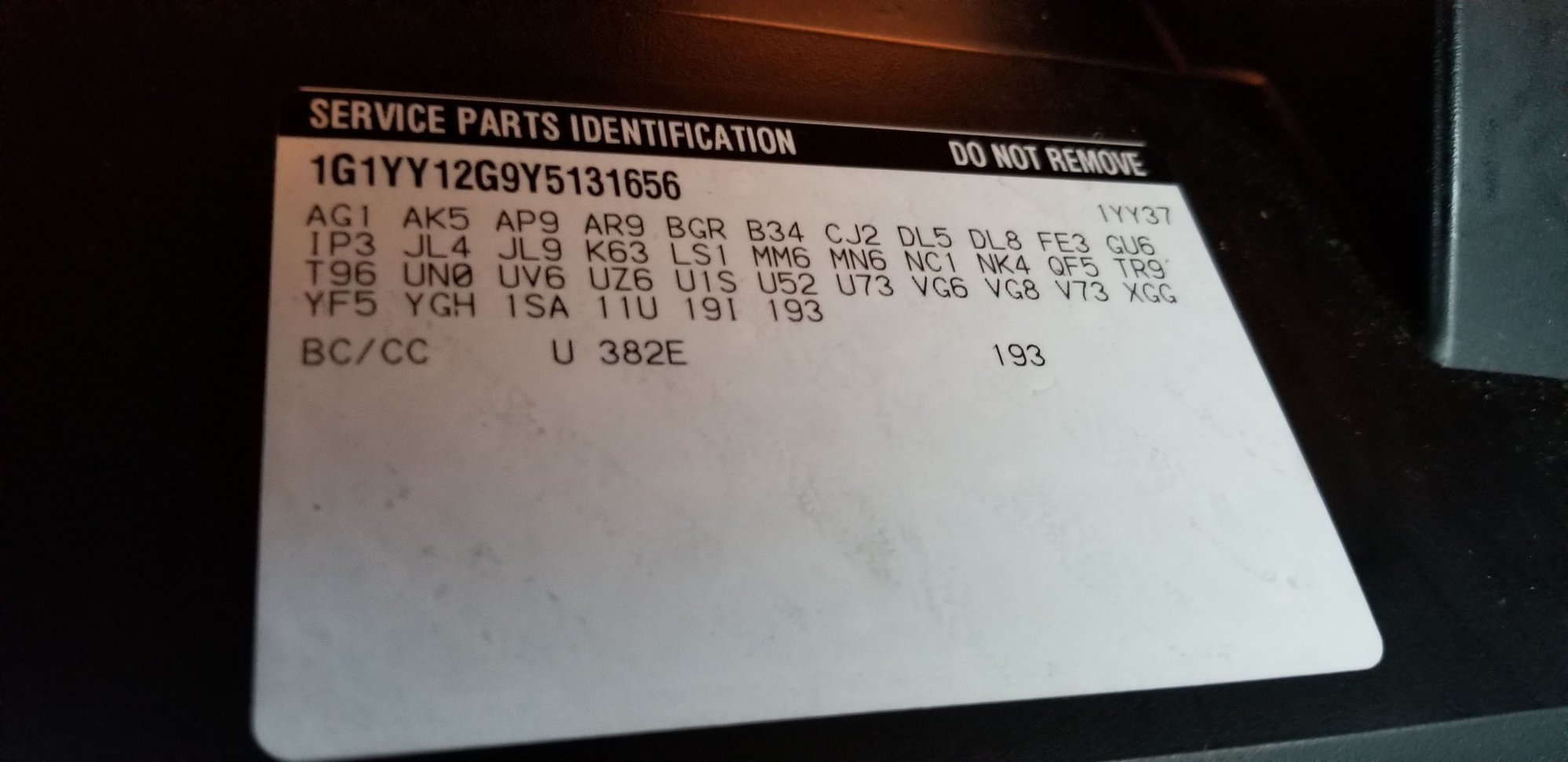

RPO sticker from my glove box. Also installed "The Stubby" antenna. Gift from from my sis. She also got me a skip shift eleminator. That will be done this weekend.

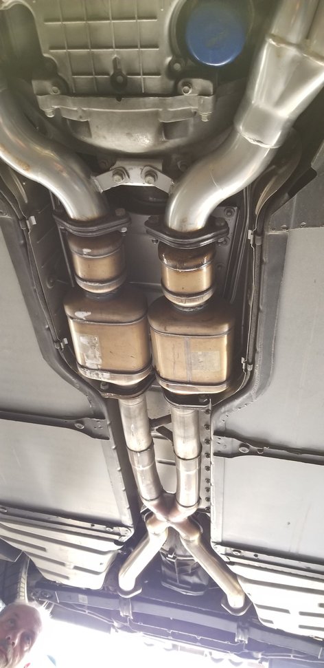

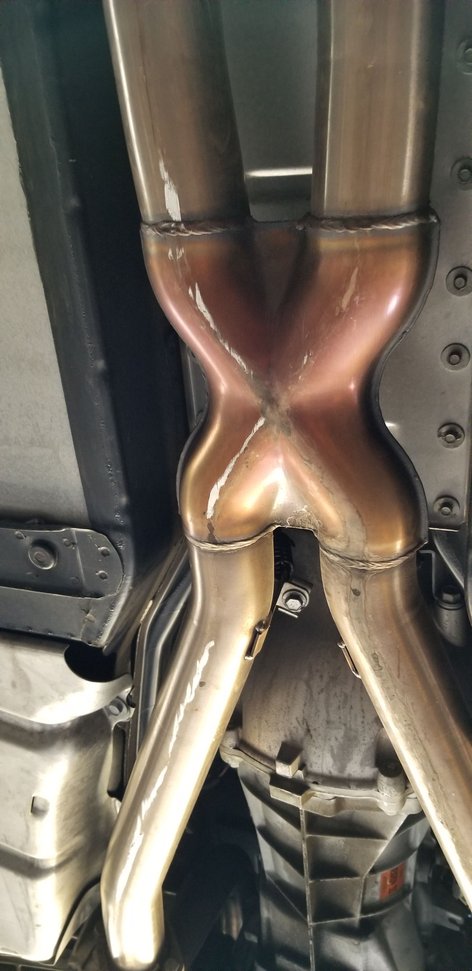

Getting pup cats removed as I type this. Here's a view from under my C5. Still don't know who makes those headers.
This car has a 2.5" Magnaflow system. No wonder the car is semi quiet at idle and cruising around.

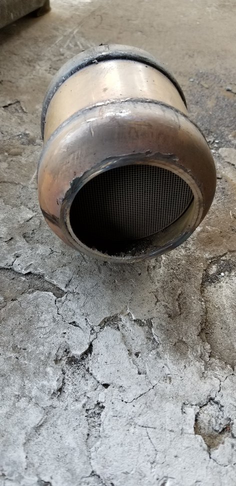

Completed!! Wow! What a difference! Sounds so much better at higher rpms. More power for sure. Reason was, whoever put that system together for the original owner, welded the pup cats right up on the main cats, which created a big bottleneck in the exhaust. The car pulls much harder now, all across the range.

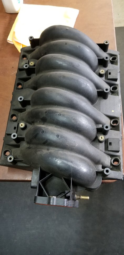

Picked up an LS6 intake at a smoking deal from a local forum member. Will be cleaning it up and purchasing some fresh gaskets for it. It came off his 04 C5 with 50k miles on it. Looking at tips on installing this. Some people are saying to grind off the ribs on the bottom and loose the pads. Any comments on that??

while you have the LS6 intake off of the car you may want to have the snout modified to fit an LS2 throttle body. That 90mm setup will yield some decent gains.

Any reason why you went with the LS6 intake instead of the Dorman/Fast 90mm intake that runs ~$350 new?
Because the FAST intakes are going for 500+ used. I got this one for $200.
No FAST sold the rights and molds to their old intakes to Dorman
https://www.dormanproducts.com/p-87302-615-901.aspx
It's a FAST but sonic welded together, has a 90mm opening and goes for around ~$350
Holy crap!!! I had no idea!!!!! I've been out of the LS game since 2008.
Wish I knew this before. Thanks for the info.
Yeah, I almost bought one with what LS6 intakes were going for before I decided to build an LS7

Oh, I thought the Dorman intake was better than LS1 intake, but still not as good as the LS6 intake?
So it's actually a FAST design and should be better than a LS6?
Yes, the latest Dorman is identical to the first gen FAST intake as they bought the molds and rights to them, except they're sonic welded together. Lots of info out there about it.
