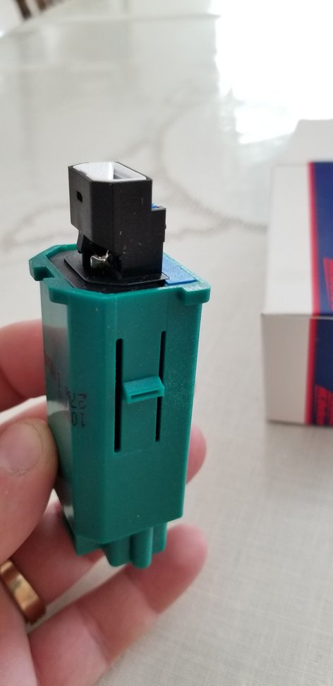

Time to upgrade this thread a little. I've done quite a bit since I last posted in this thread. Replaced the ignition switch that was causing mystery issues with the car dying. Installed poly bushings on my stock sway bars, installed a new system and ditched the junky Bose, repaired the drivers seat rock issue, installed new tires (stock sizes, nt05 Nittos and firestone indy 500 fronts), hazard switch, and finally this!

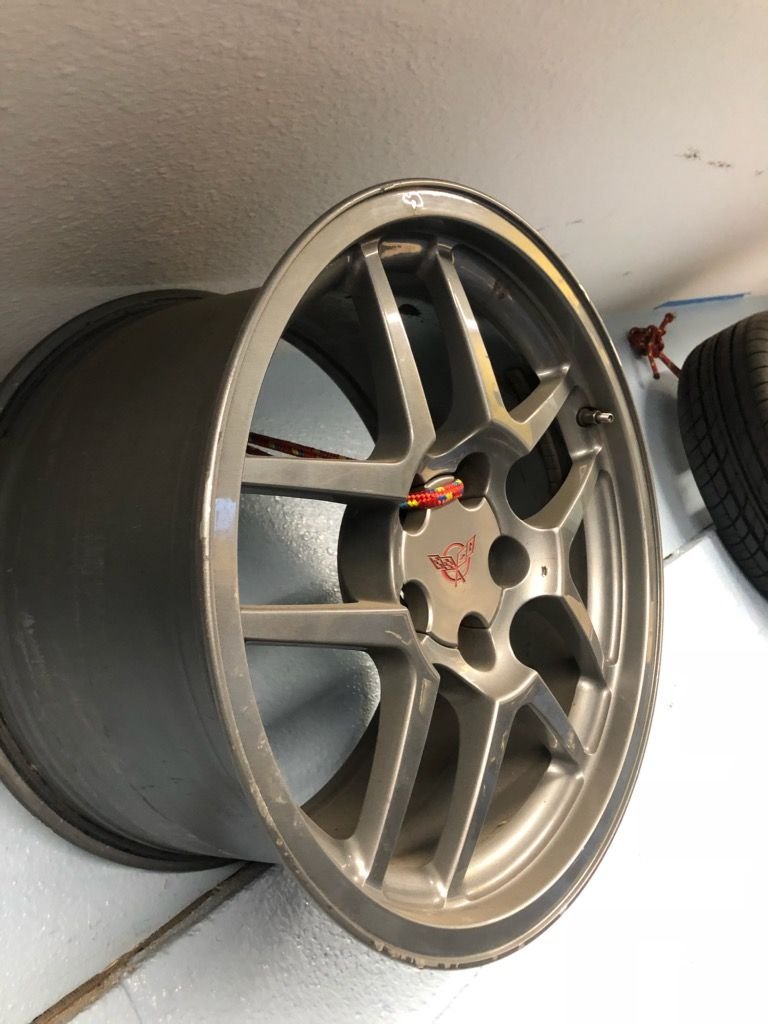

I apologize, I forgot to mention I picked up a set of original 2001 Z06 Alcoa wheels for $400. One of them had some paint chipping and light curb rash. The other rear wheel has one chip of paint missing and the fronts are mint.
I did take the worst Zo6 Alcoa wheel to a wheel shop who is charging me $150 to strip the wheel. Repair any damage and ppwdercoat it. The other 3 wheels look fine. My plan is if it don't match well, I'll have the same side front done and that will be it. Then it will be a matter of getting some tires, which are $$$$. More coming soon.

One wheel is complete and it came out darker. So now I'm having all of them powder coated. They will mount and balance my new tires as well. I love the darker gunmetal color.

Alcoa wheels with darker powder coat.
