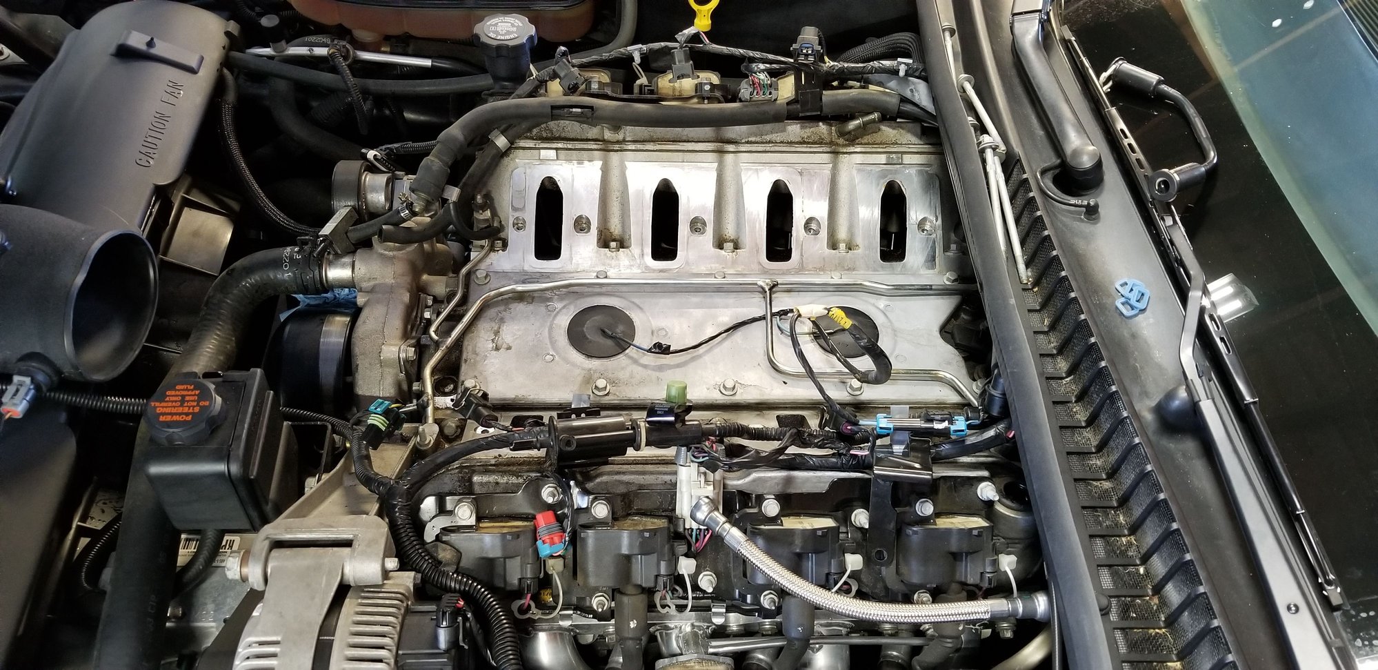

It's been a while, so here's an update. I decided to also replace the front swaybar links, they ended up being shot as well. So stock C6 links went in. I finally installed the LS6 intake manifold with the help of a good friend and forum member here. I had an appendectomy a few weeks ago, so I am still a little soar. The help was very welcoming. The LS6 intake was a nice addition to the LS1. It has more low end torque and pulls freely all the way until I shift at 6k rpm. I will have the car tuned in a few months, to compliment the rest of the mods.
Stock LS1 intake
LS1 left and LS6 right
Ground down all the raised plastic lines on the LS6 for better fitment. I also smashed down the factory steam tubes a little where the engine valley is. This really helped with fitment. Not much was needed on the tubes
Steam tubes slight hammered down.
