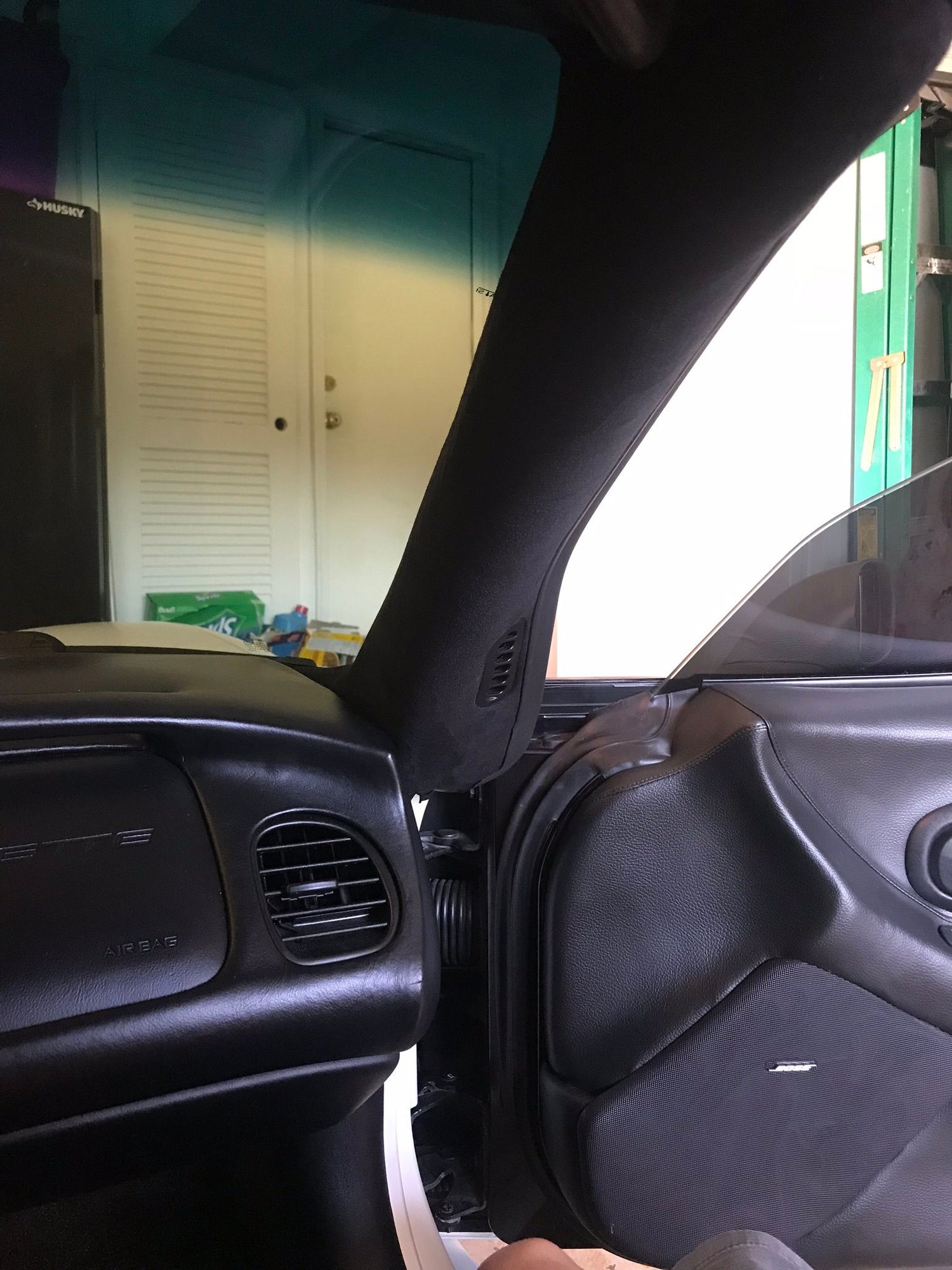

I am almost complete with my interior. My door panels have been redone with vinyl as it looks and feels like leather but wears better. And changed color as they were black and grey. Now black. Few grey plastics I was going to spray place but found some were not in great shape and found them cheap to replace. Other areas like A pillars I wrapped in suede.headliner suede with diamond stitching, Shift boats suede, visors suede. We are about to pull the dash and wrap that in same vinyl as doors due to starting to have a minor wave. New carpet, wrapped the kick bolsters and glove box. The radio bezel is re textured as got molded new double done and gauges. (Will be done Monday).
Wasn’t bad of process. We did most of interior work as we were wrapping the car. Don’t have any decent pics yet. But here is some. Will get more when car comes home.

Nice work! I just received my diamond stitched vinyl for the headliner. How did you do it? I have the Mid America insert, and was going to recoat that with the diamond stitched material.

We actually just made a whole new headliner. We started suede headliner material as it has small bit of foam. Stitched the diamonds and then we used the factory headliner as template and cut new foam the wrapped the diamond stiched section to it. We went just a tad thicker then the factory headliner. Glued it to the top. Wasn’t hard at all. Well stitching the Simone’s sucked. Took them a good bit of time. But after it was stiched. Took us about hour to cut, glue, wrap and glue to top. Friends of mine have a tint/upostry shop. So most stuff I have don’t to car is custom as something could not find exactly what I wanted. Or the didn’t have it. At the end it turned out cheaper as well.
