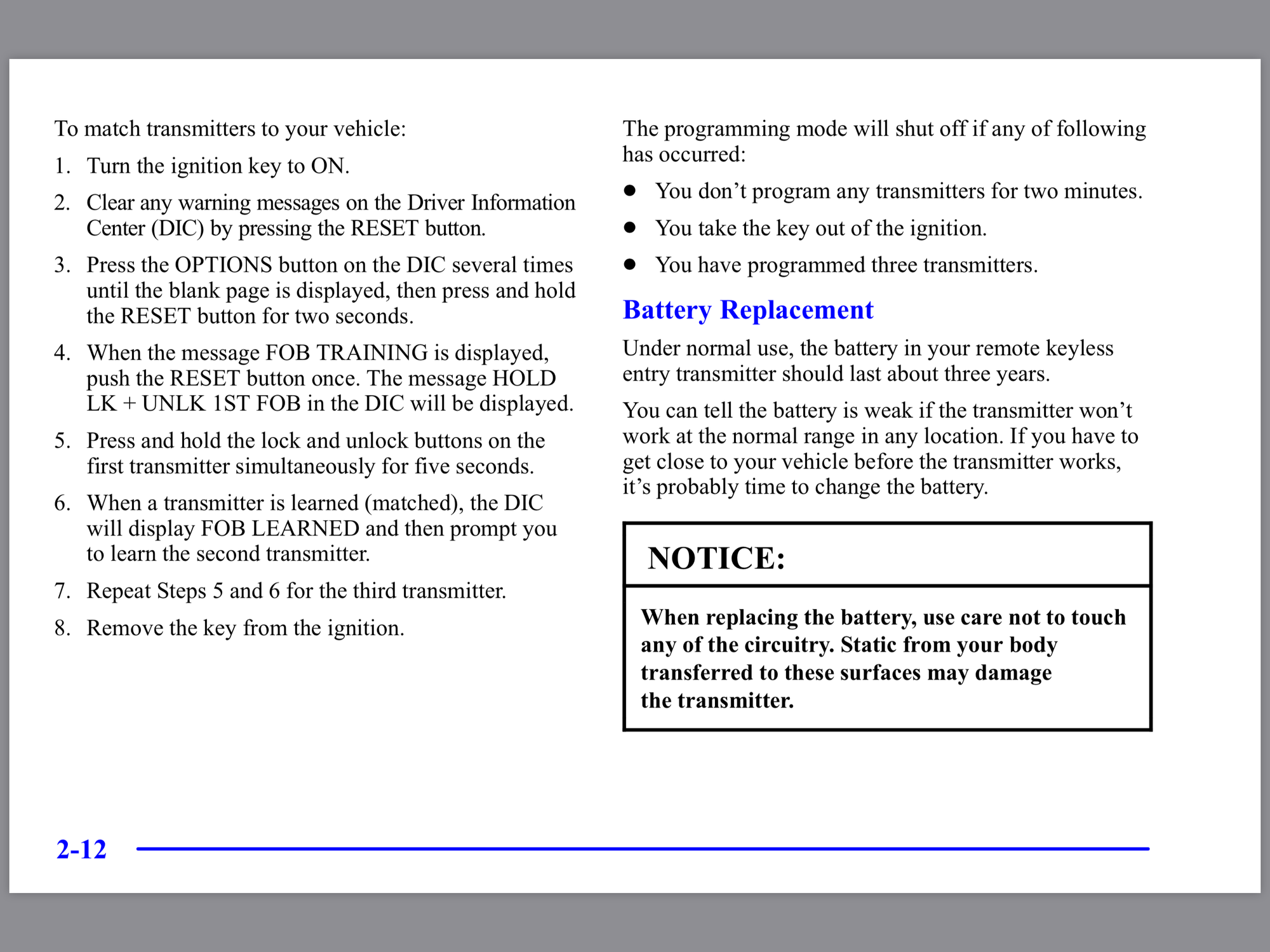

I bought a couple of new key fobs, as I've only got one old one. I went to the website to get programing instructions as directed in the purchase. Nada, nothing, no instructions Does anyone have any advice as to how to program the key fob for a 2003 ZO6, without paying a locksmith or taking the car to a dealer?

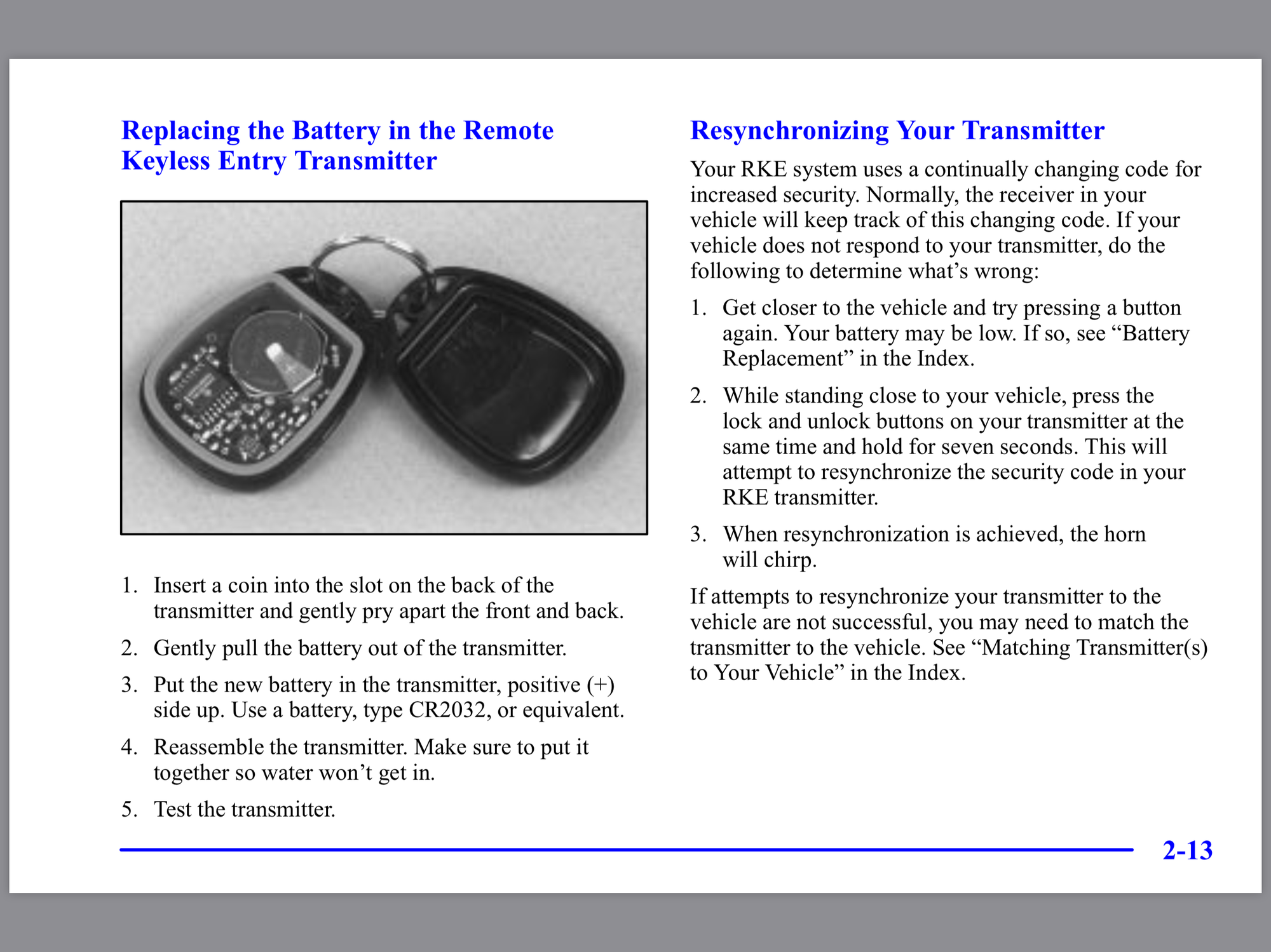

Might try the owner’s manual

The instructions above look right. I added two more fobs for a total of three and programming them was remarkably easy if you follow these directions.
