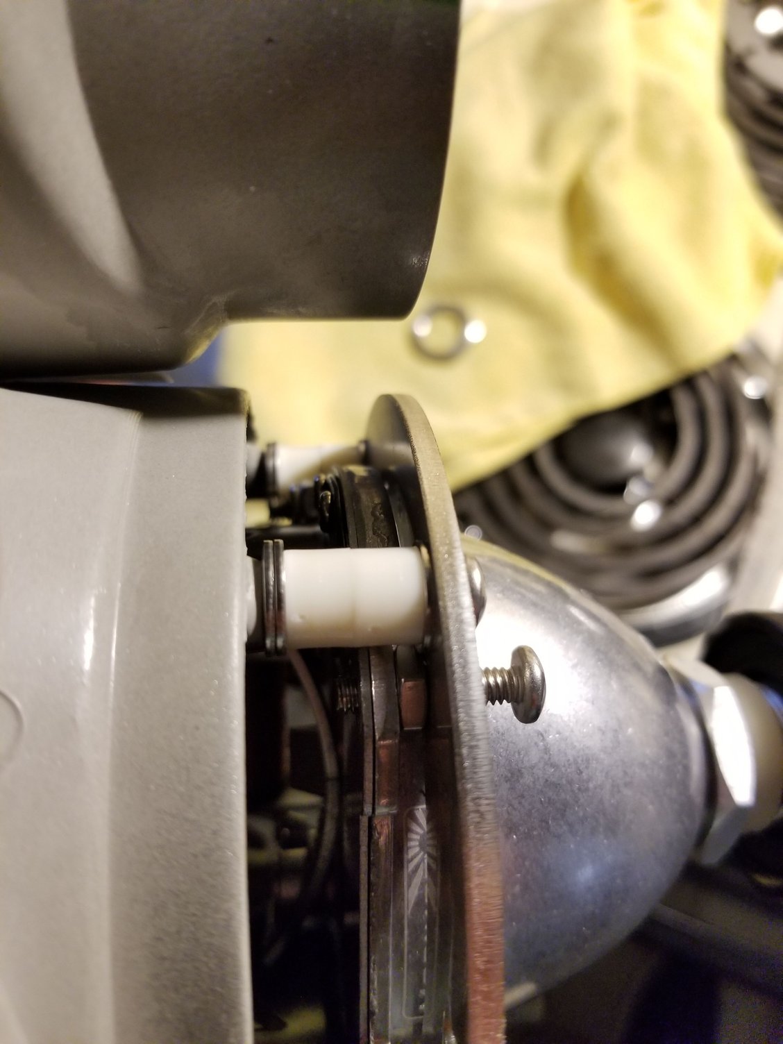

Originally Posted by InfiniteReality
I like how they seal things up, nice and clean. What is done to protect the solenoid from the elements? Or are the Morimoto's solenoid in front of the mounting bracket?
Everything is inside the bracket except the backside of the reflection bowl. Here is mine, as it sits now. The two screws are loose because I'm getting ready to install a bracket for LED demon eyes.
I may use butyl tape on mine due to lack of surface on the bracket for mounting weather stripping.
