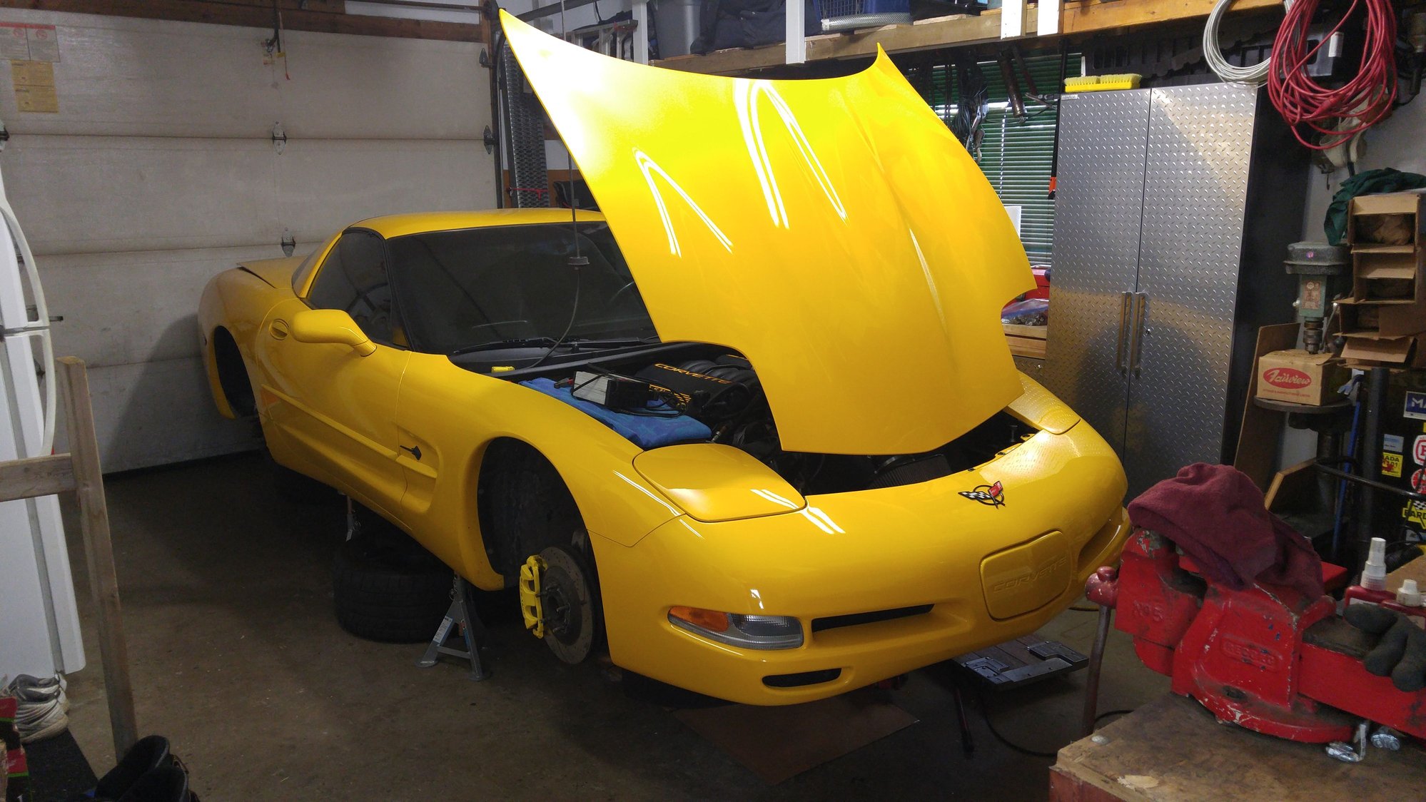

There's something satisfying about getting your car up on jackstands for a little bonding time. Brakes redone with new pads, SS lines, ATE fluid. The rotors have surface rust from sitting so long, but are in good condition. Next time I'm in there I'll probably rebuild the calipers and install new rotor but the test drive showed they are working very well. Multiple hard stops to bed the pads, straight and true, and the ABS kicked in as it should. Also flushed the clutch fluid and chased a small coolant leak - lower hose manifold had a bolt that wasn't tight. I'll keep an eye on that one.
Today will be de-stickifying the steering wheel and a general cleanup of the interior. There was clearly water intrusion while it sat outside, resulting in the typical issues. Some Borax and elbow grease for that. I'm also going to try and pull the HVAC controls and fix the bad resistors inside.
