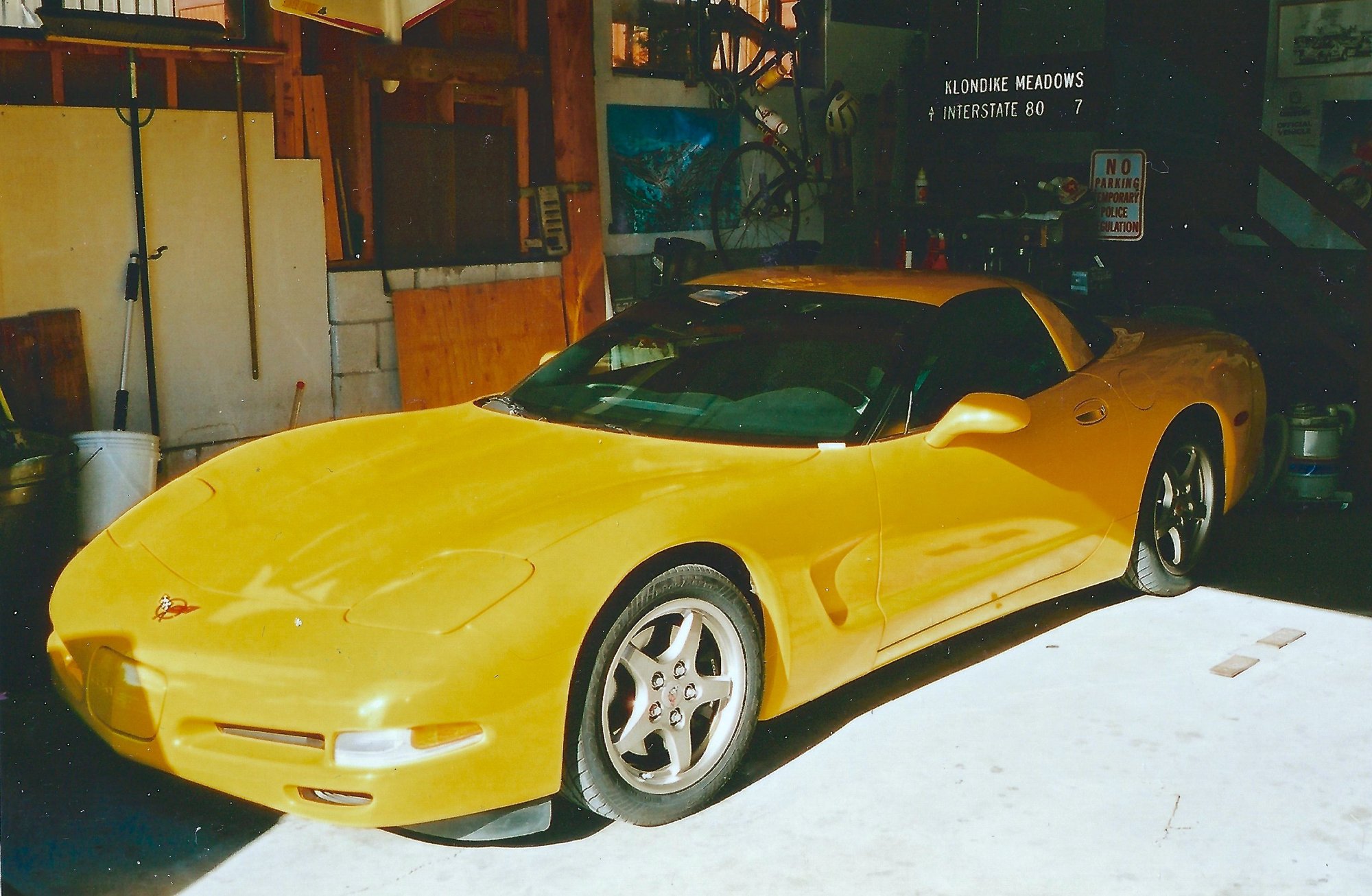

Moto One's Avatar
Moto One
Joined: Sep 2006
Posts: 1,335
Likes: 167
From: Truckee CA
I paid extra for what was suppose to be a one year only color. When the 2001s came with the MY, I traded it. TR Z06 because all Corvettes are. Really I need the Z for SCCA National Tour. Loved the MY.
Mark.
