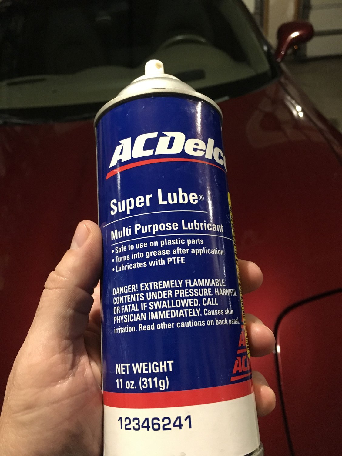

Originally Posted by Corvette#2
I used AC Delco PTFE grease once a year. Put a newspaper behind the hinges to catch overspray.
I also agree with the use of white lithium grease

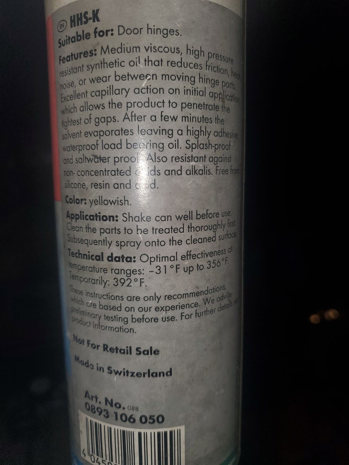

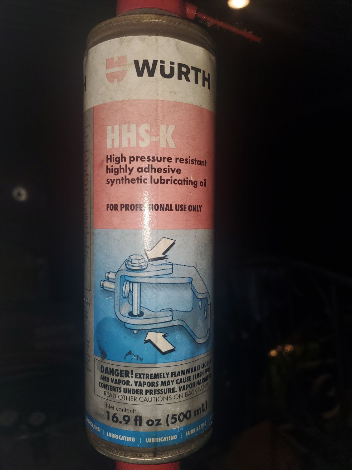

Default Favorite lubricant
Originally Posted by jjc508520
What's the best way to do this? I keep shooting silicone spray on them - and besides being messy I don't really think its the right stuff to use...
Worth HHS-K is my go to for most items that don't require extreme pressure lubrication.
You can read for yourself. A little spendy, $18-$24, but very much "Wurth" it!
