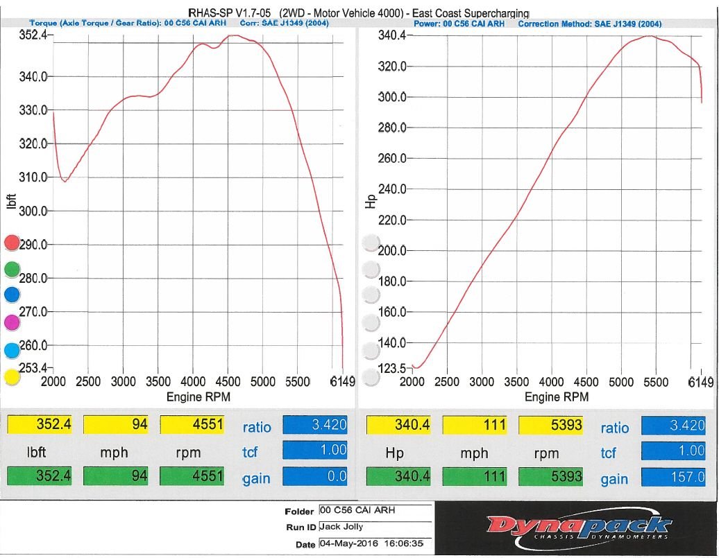

My 2000 with "flip-tie mod" air cleaner - 180 tstat - LS6 intake - ARH headers - CPU tune - dyno sheet attached - work done by ECS...
Is that an A4 or manual car?
Manual - FRC
