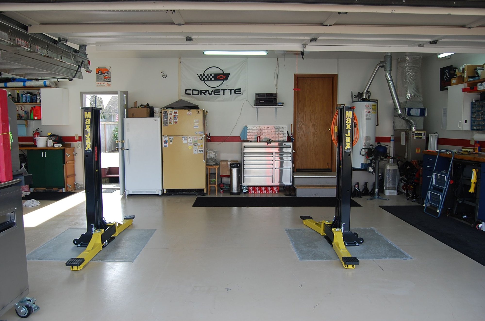

I have a MaxJax that works well for both my C4 and C5. My garage is 9-1/2 feet high so I didn't really want to deal with a 4-post drive-on or a larger 2-post. My MaxJax will lift 46 inches and it came with extenders for the arms that are 4". I have one of those Harbor Freight stools that allows me to sit down and roll under either car and not hit my head. I was easily able to install headers on my old '87 without any height problems.
One thing to do with a 2-post lift is to make sure that the concrete floor is solid. MaxJax says you need a minimum of 4" thickness when using their provided wedge anchors. Also no cracks within 6-8 inches of the bolt locations. Turned out my garage floor was only 2-1/2" thick and there were some cracks right where the posts would be. So I had a concrete company come in and the tore out a 4'x4' section of the floor for each post and poured new concrete (5000 psi mix) 12" deep with rebar connecting the old floor to the new pour. I wound up using 8" long epoxy anchors.
Note that the kegerator is only about 8" away from the lift. I can sit on the stool and it only takes one push to roll over to the tap!!
