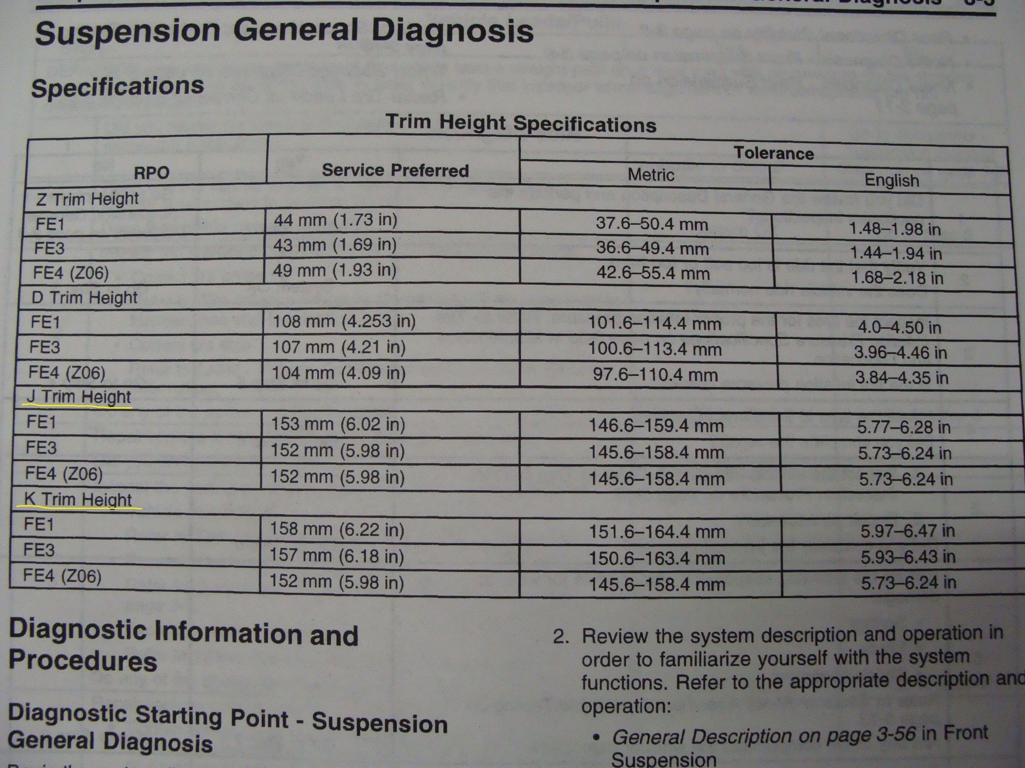

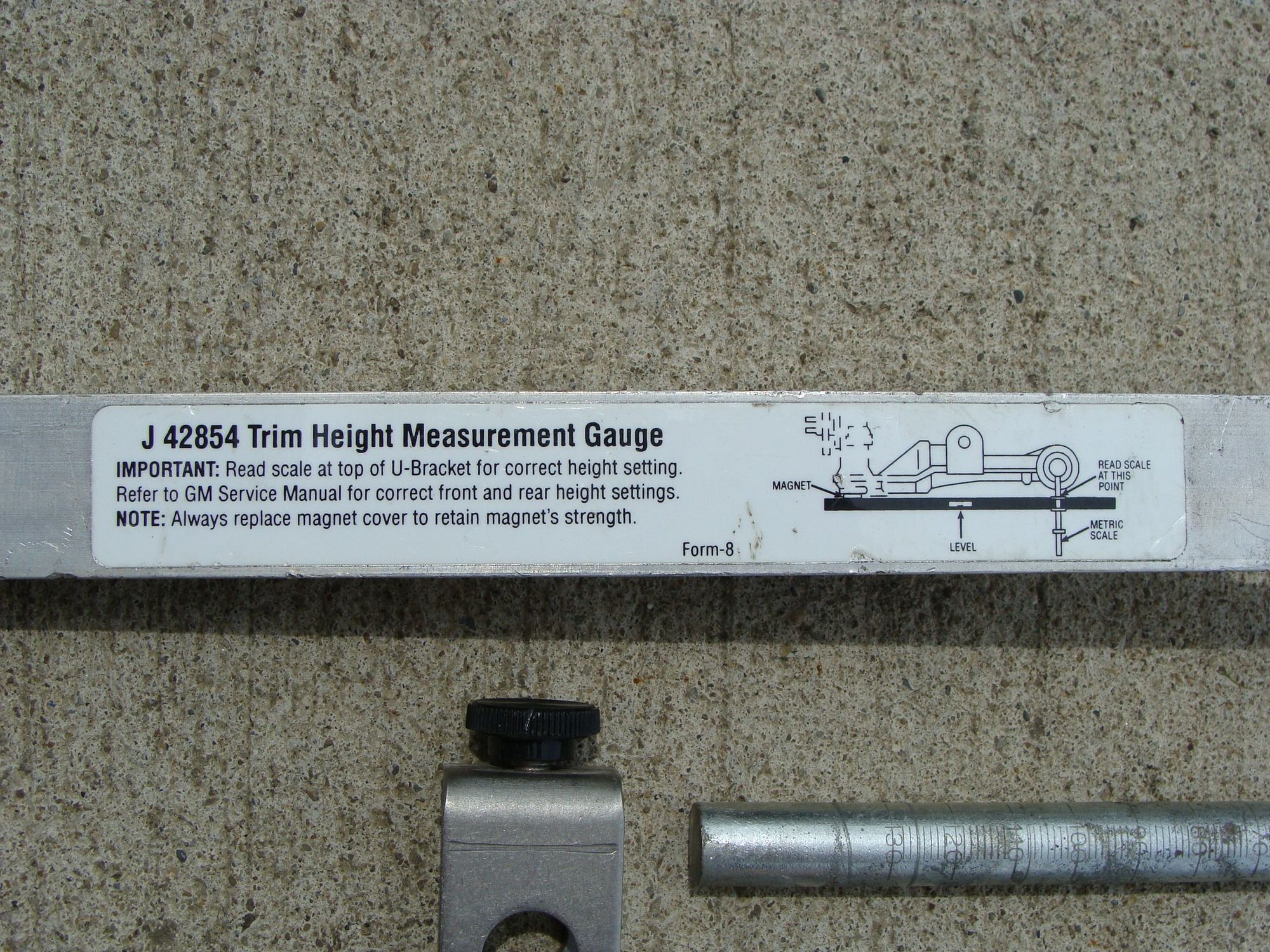

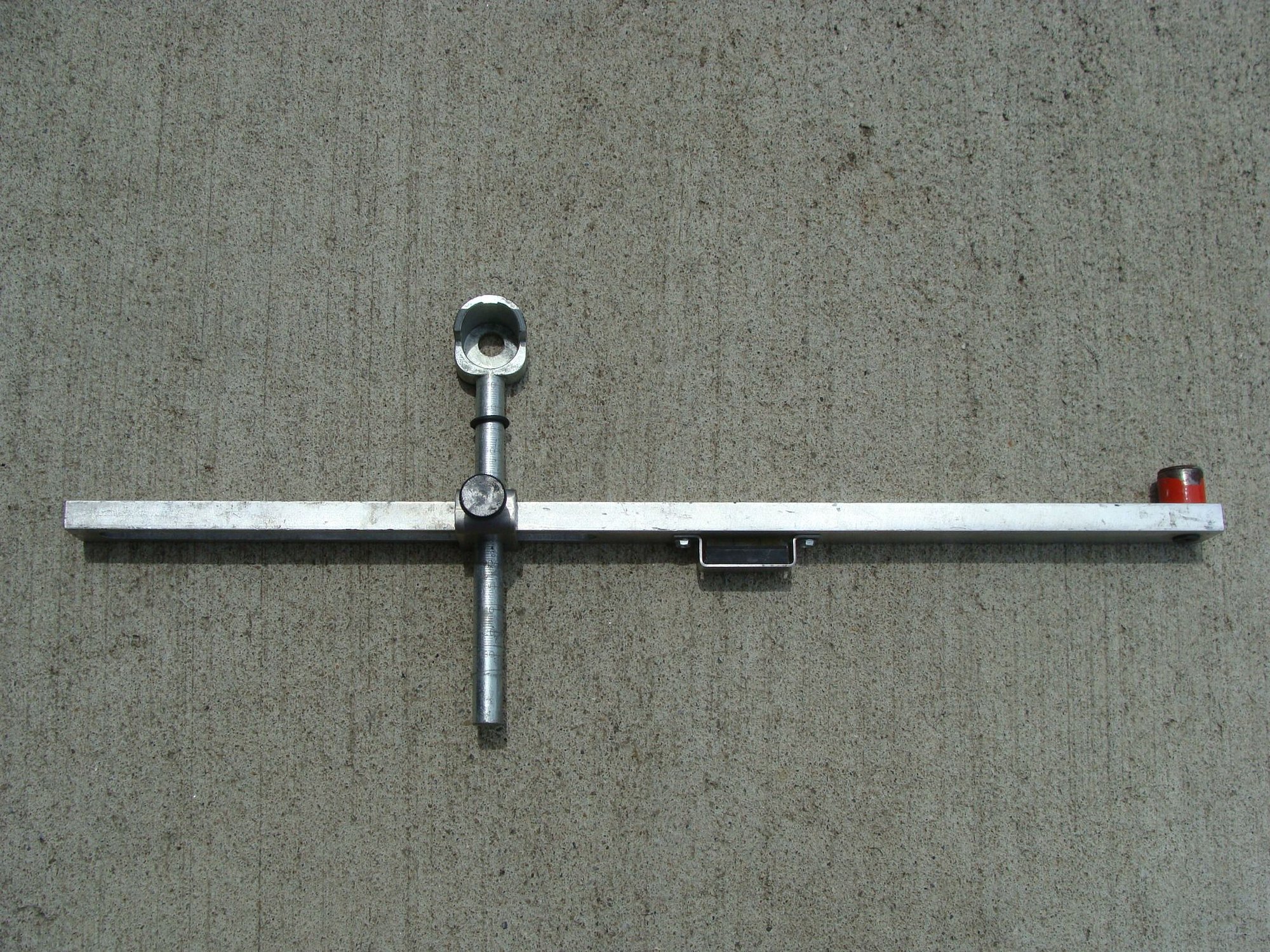

OK the tool shown below is what a dealer would use to set the ride height, but the car needs to be on a lift, & most people do not have these, new they are around $300 this tool is what is used to set your "Z" & "D" trim heights as noted below on the spec sheet using the lower control arms, the markings on the round bar are in mm's.
A simpler way is to use your jacking puck locations J & K trim heights as marked in yellow on the spec sheet & noted on the 3rd photo.
So if you have a coupe or convertible it is easier to install a puck & make sure the top of the puck is pushed up against the frame & measure from the bottom of the puck to the ground obviously with the car on the ground & then add the height of the puck into your measurement, & hopefully you would be on a hard level surface.
In the spec sheet the stock measurement listed under service preferred column you will see the specs J is the front & K is the rear, to keep it simple 6" in front & 6-1/4" in the rear that would get you back to stock ride height assuming you are running stock tire sizes 275/40/18 & 245/45/17
You were close on your wheel well heights as well, I think mine were 29 & 27.75 I never recorded it so that is close to what I remember. You can use that to measure but is not recommended as the body panel may be off. I will admit I like all my gaps to be equal so I use the puck locations & I also measure from the bottom of the wheel well to the top of the rim to fine tune.
On the spec sheet you will also notice that Z06 J & K specs are level, the Z06 rear tire was shorter than stock C5 so that lowered the rear some. I used that as my base line, these cars look best either level or higher in the rear. On mine having same diameter tire F & R if I was to set the gap the same F & R the car would be squatting in the rear, not what I like, so I ended up at 26.5 & 25.75 from the ground with a level J & K spec of 3.75"
If you want to lower your car from the stock height for looks, just reduce the J & K specs equal F & R so you still keep some rake.
Forgot to add I am not sure how many turns equates into inches of raising or lowering, you just need to keep adjusting & measuring till you are where you want to be, & adjusting bolts are a lot easier than coilovers.
Hope this helps.
