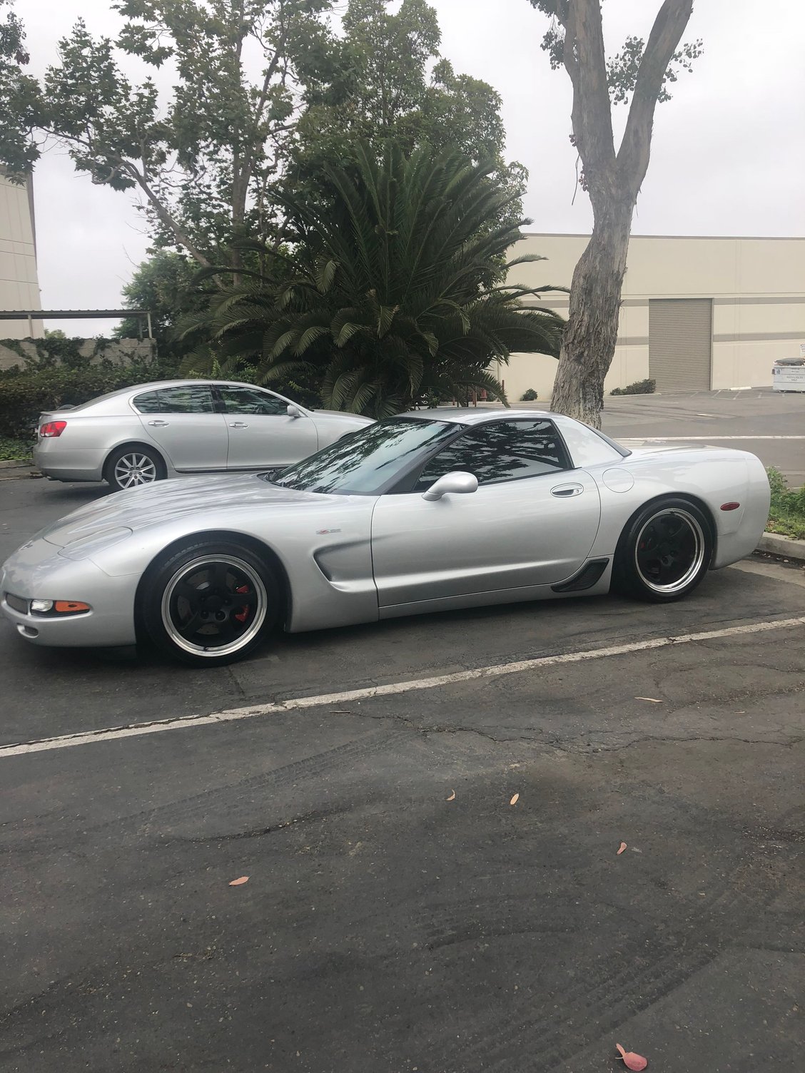

Here is my experience. I purchased my C5 about a year ago. The previous owner had it lowered all the way down of the stock bolts. The stance looked killer, but driving the car was like walking on egg shells. Driveways, speedbumps, valley gutters, potholes.....no matter what angle of approach I took, it would scrape.
A short while after purchasing the car, I put it up on a lift. There was a large dent in the oil filter. 2 of the 4 bolts that connect the exhaust headers to the x-pipe were sheared off. The headers and cats both had some scrape marks.
In my opinion, it's not worth the risk. I raised it back up, not quite to stock height. Even then, I struggle not to hit the skid bars under the front bumper just pulling in and out of my own driveway at a 45 degree angle.

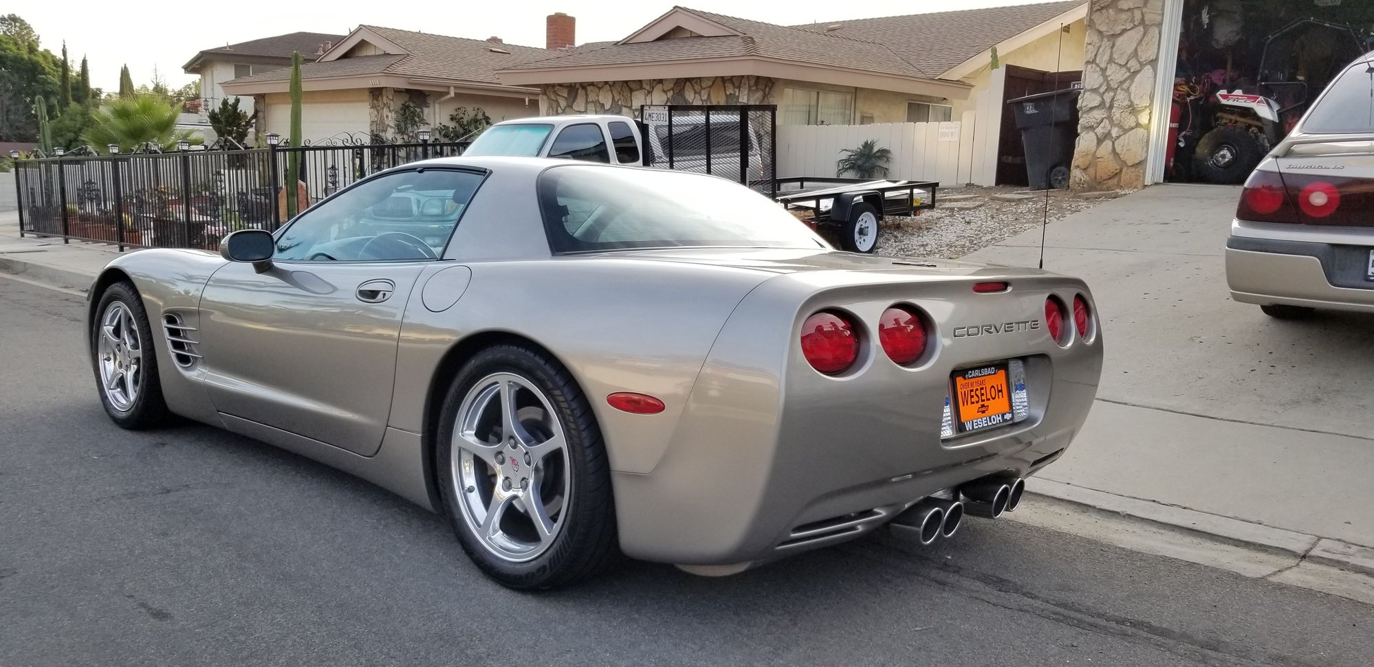

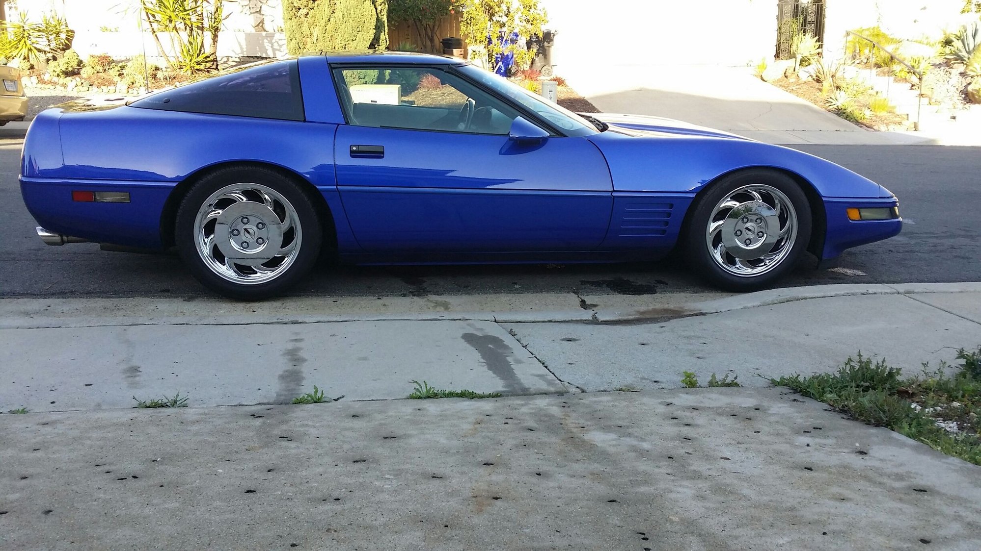

Chris pretty much hit the nail on the head, but let me add some more important details. I've owned 2 Corvettes now and when I purchased them they were both lowered. My C4 was completely slammed, to the point where it was falling apart and dangerous in the turns. I ended up lifting it back to stock and replacing many broken suspension parts. My C5 was also lowered, not as bad as the C4, but pretty low on aftermarket bolts. One thing you have to consider is the ride. Lowered on aftermarket bolts will ride like total ****, I don't care what anyone says because I've experienced it. If your in a turn and your going high speed, hit a little bump and see what happens. Since there isn't much travel, it will bottom out the suspension and throw you out of a turn, then you either get lucky or you crash. These cars will actually handle better at stock height with good sway bars and shocks, than slammed on stock bolts or worse, aftermarket bolts. On mine I left the front slightly lowered and lifted the back up a little so the suspension has some travel and ride smooth enough without getting trashed. I would stick with stock bolts and play with that. If you want to go lower, then look at other options and stay away from aftermarket bolts.
C5 lowered on stock bolts.
Lowered on stock bolts the way I bought it. Hit a small dip in the freeway that day and almost screwed up my back. I'm 42 and have a good back btw.
C4 slammed with aftermarket bolts. Rode like garbage, almost blew out a few teeth fillings with this ride.
As my C5 sits now, slightly lowered on stock bolts with stock wheels and tire sizes.

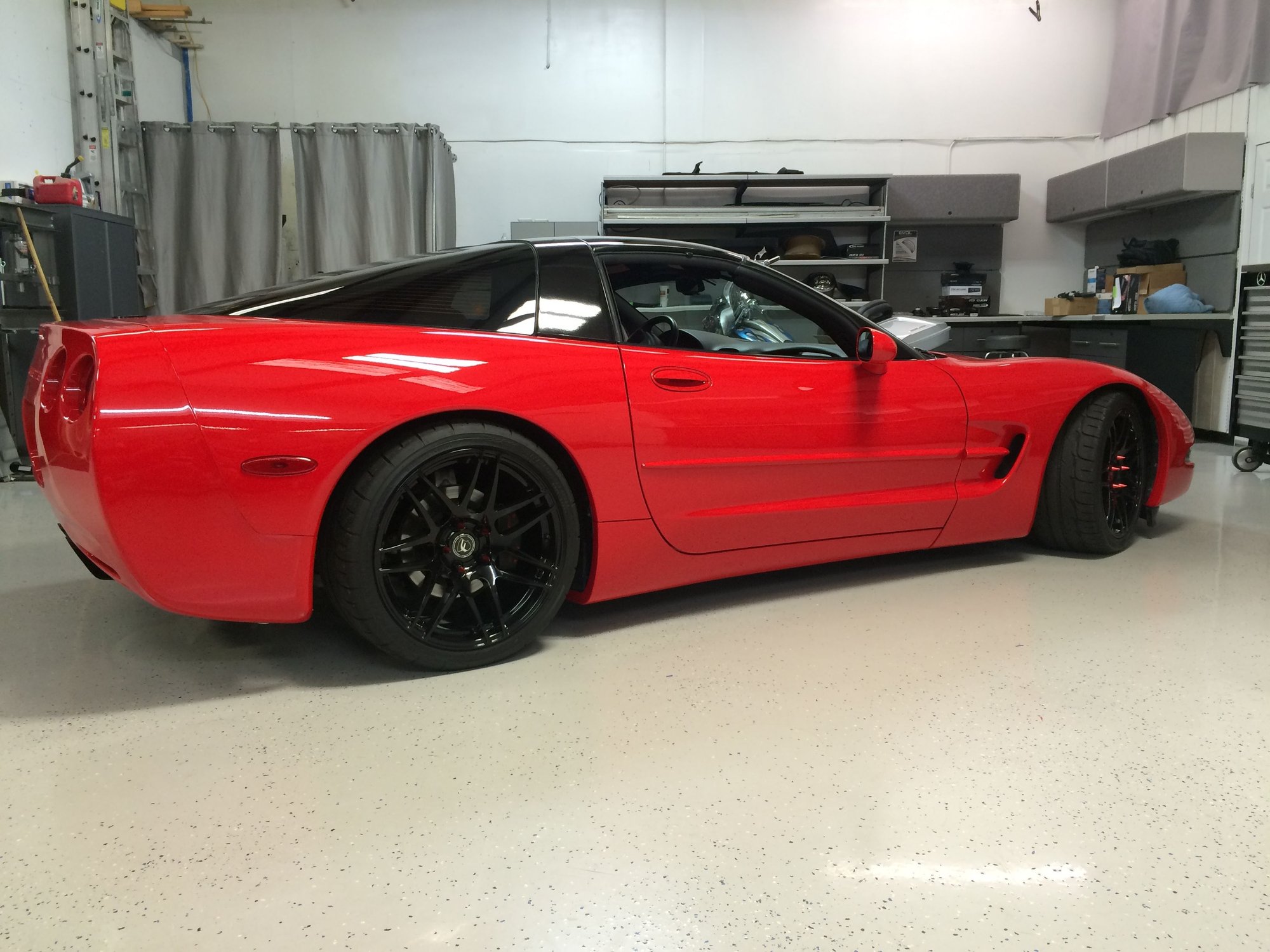

I'm going to chime in from the coil over crowd. After I installed my coil overs, the car road smoother lowered than it did at stock height on the leaf springs. I didn't change the sway bars and it still corners flatter than it did, and as was mentioned earlier no more rear end hop in bumpy corners. There are no rattles or squeaks. I have a front lip that I have to be careful of, and I have scraped on some monster speed bumps that we have here, but all in all it's livable. I don't track mine either but I personally think that it was worth the investment.

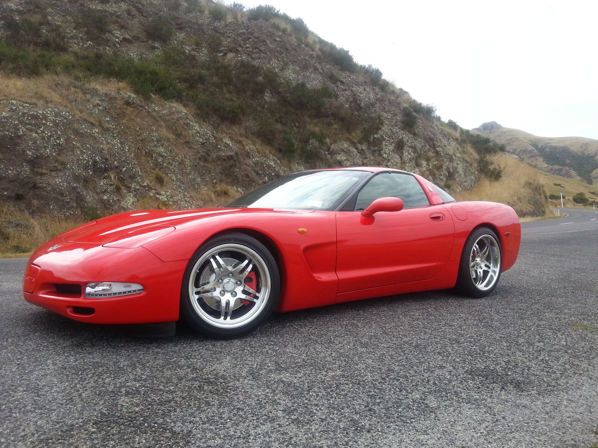

Used aftermarket bolts, ZO6 sway bars along with metal end links. and KYB gas shocks.
