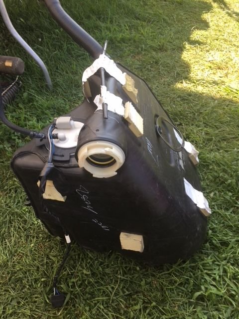

I took these pics at Carlisle - I believe they are 2 shots of the same tank. There are 2 - about 8gal each - connected by a big hose. The one pic shows "2004" on the side - I believe there are differences between these and what's in my '00...

These are actually different tanks - the one on the bottom has the smaller hose that runs to the fuel neck and the other a fatter hose that connects to the other tank. Is the ‘jet pump’ in either of these?

I took these pics at Carlisle - I believe they are 2 shots of the same tank...
It seems to me they are 2 sides of the same tank (driver's), as mentioned by the person who took the pictures
