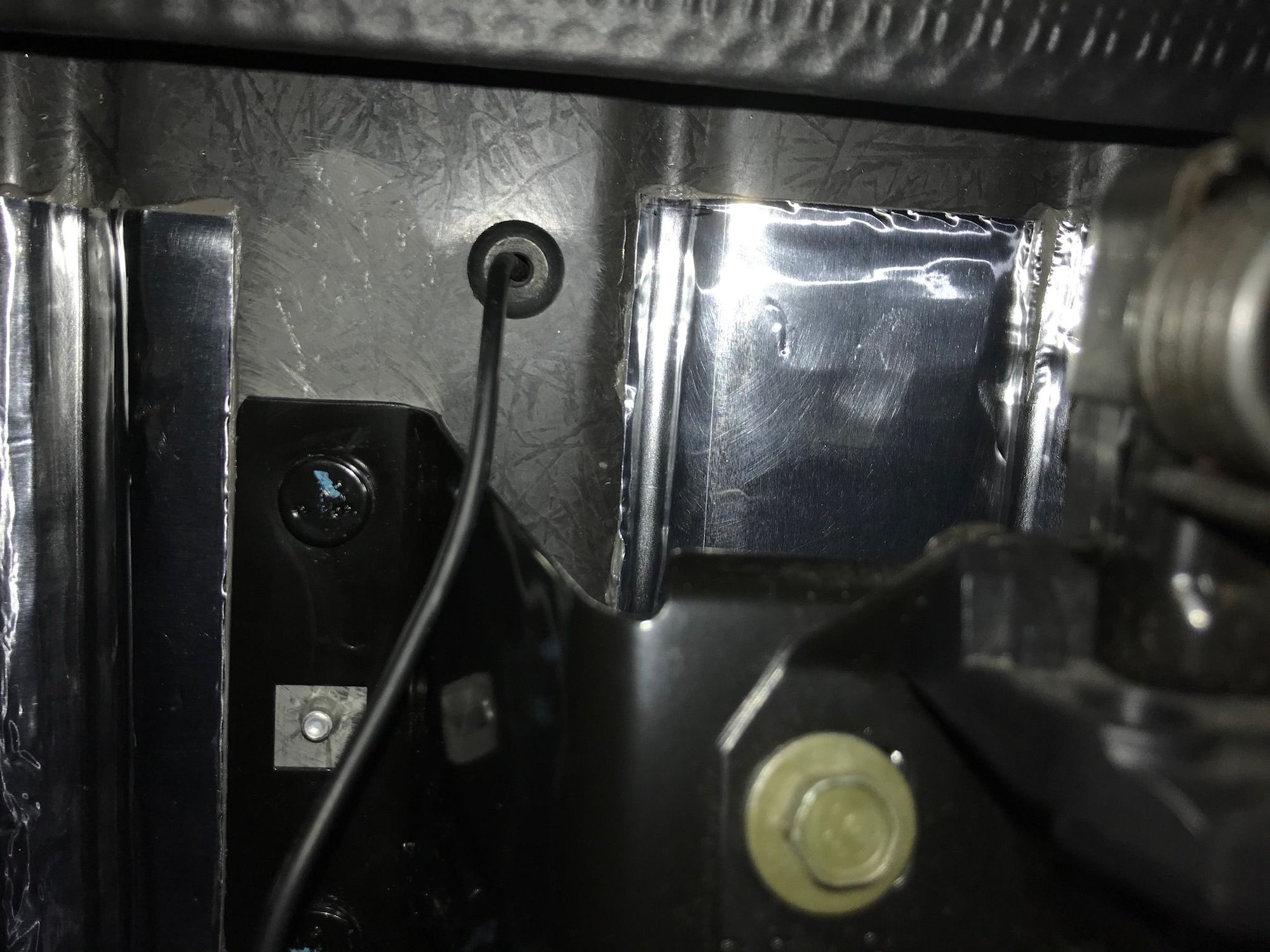

Just installed a license plate camera last week in a 2004 vert! My cable came with a rubber grommet already on the cable. Drilled a 3/8” hole high up next to the trunk latch. Also the pocket behind the trunk latch bracket is a good place to hide the extra camera wire! Even if you can’t get a grommet on it you can seal the hole with silicone. This fiberglass drills through like butter.
Old Oct 8, 2018 | 10:44 AM
JB-I's Avatar
JB-I
Joined: Aug 2016
Posts: 25
Pic of backup camera through rear of trunk.
