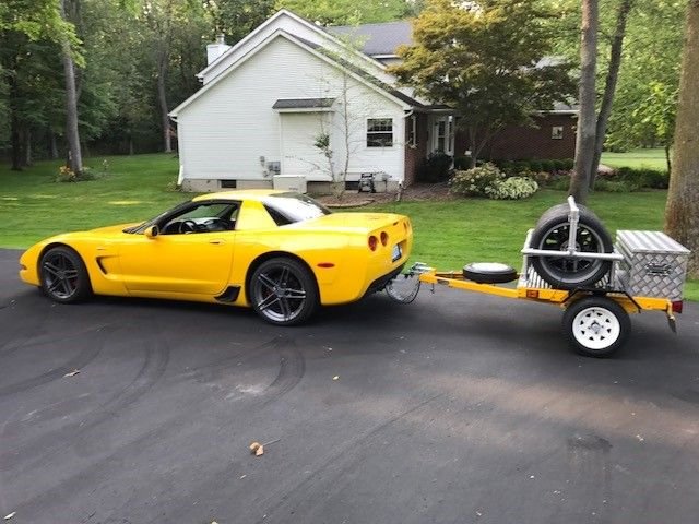

HERE is a good thread on the Harbor Freight Trailer conversion. I posted my use/conversion of the HF trailer on that thread as well.
I run a 315 square tire setup for track use so I needed/wanted at least 48" wide platform. The 48" long HF trailer is only 40" wide.
The Leroy Engineering trailer is very nice. The base model only holds up to 295 tires. The Leroy Engineering trailer that supports over 295 size tires start at $1750.
I enjoyed reconfiguring the HF 4'x8' folding trailer to a 4'x4' with tool trunk and it supports the 315 square setup tires perfect. I did it in my basement over the winter.
