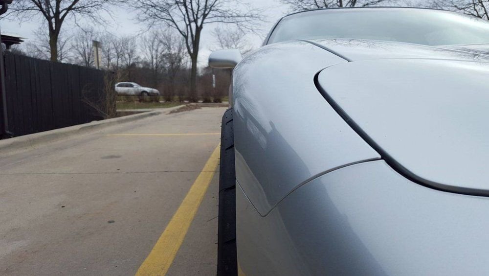

Do you want faster times? Tire width is a major factor in that. Going wider of a tire is going to yield faster results even if the tire is taller. Having a bigger front tire patch is going to give you a big boost in turn-in grip. Also, yes, you'll be able to actually rotate your tires. Last season I got 158 runs out of my RE-71s (275/305 setup). This season I'm running square 315 Rival-S and plan to rotate them out after each event and expect to get even more runs out of them. More than 150 runs on 200 treadwear tires is killer, and I plan on maxing it out this season.
I could care less how it looks when I'm at the top of the Raw and Pax times. Get a 2nd set of wheels/tires for daily driving if you're that worried about looks. But more tire = more grip, which = more hard front braking, faster turn-in speeds, more turn-in grip, and ultimately faster times.

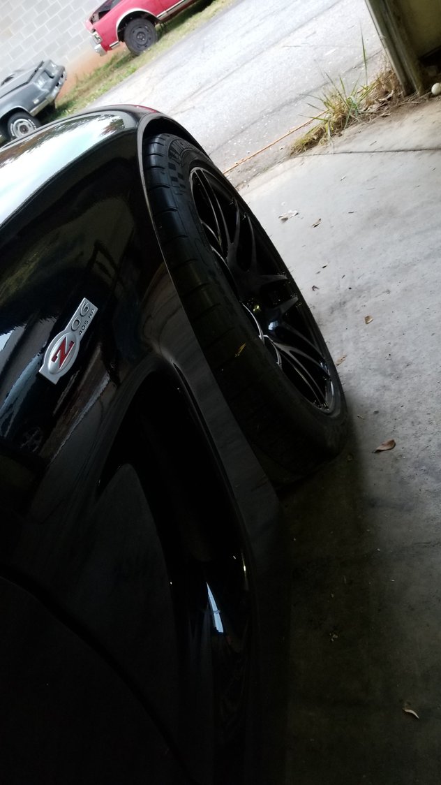

I've got 18x11's et53 on all four corners. I put Michelin PSS's 295/35/18 on all four. It's an 11" contact patch and the shoulders roll in nicely, making for very good fitment with a bit of camber. I personally feel it's the best modification I've ever done to the car...and my car has been through the labyrinth of mods. The front end of the car finally appeared and feels like it should have. Much more balance out the car, far more front end confidence.
I can't say I'd go with 315's but...my setup feels balanced both in terms of looks and ability. My car runs a slightly lower ride height and the only rub I get is at nearly full lock, the front tires touch the bumper inner plastic liner ever so barely...in other words, no concern whatsoever.
