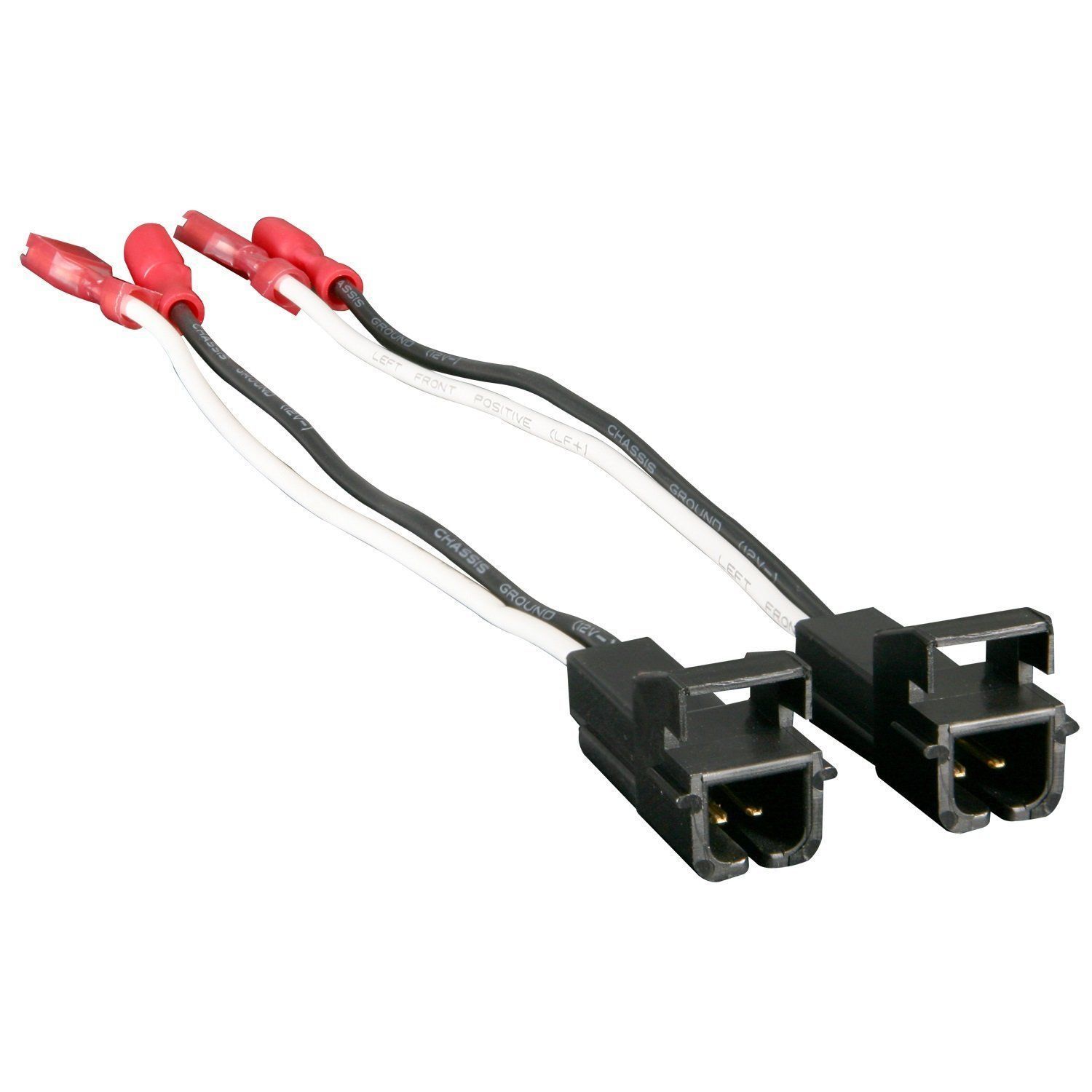

You are going to need
<b>this kit</b> this kit
as well. One kit will do both rears.
