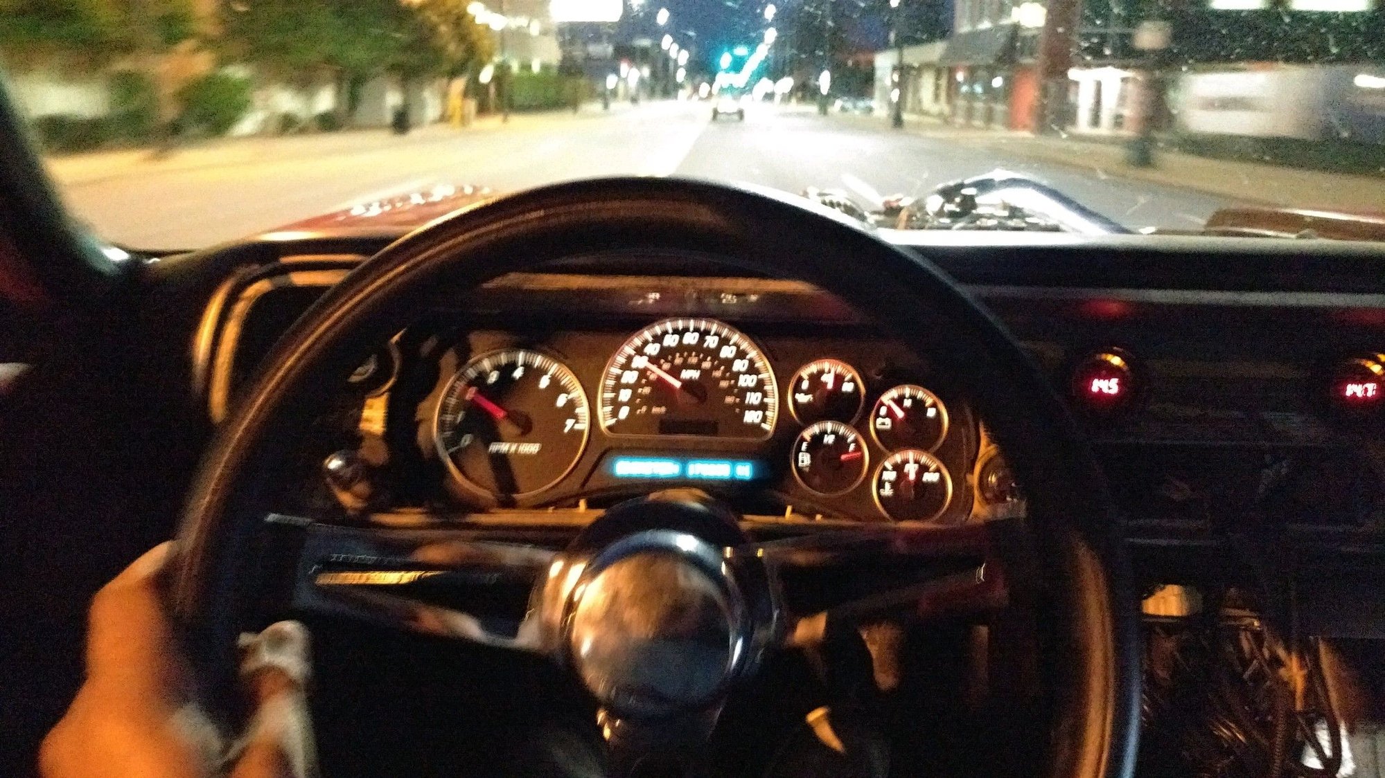

dbgoodwin's Avatar
dbgoodwin
Joined: Feb 2013
Posts: 4,346
Likes: 755
From: Greensboro Nc
Is there a particular reason you don’t want to run gauges? A lot of people tear out the cluster from trailblazers when doing LS swaps. Here’s my friends chevelle gauge setup:
the only thing that doesn’t work is the voltage gauge as that gets its signal from the BCM.
