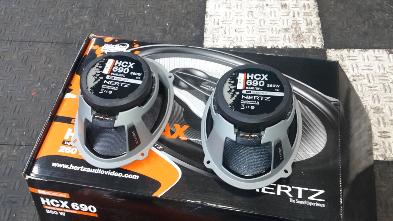

You can easily put any 6x9s of your choice in the doors.
All you have to do is gut the grilles and put them behind on the back of the speaker
to space it out so it clears the power window track.
The door panel fits fine lots of clearance.
To go with the 1200 watts rms from the old school Rockford Punch amps I'm currently running an Audiobahn sub with premium Hertz 6x9s in the doors and 3.5s in the back and volume adjustable tweeters at the top of the A pillars.
The cheap 50.00 high power 350 watts rms Pyles finally wore out after having them in various vehicles for 18 years when one died so I upgraded to the premium quality 300.00 Hertz HCX 690s
