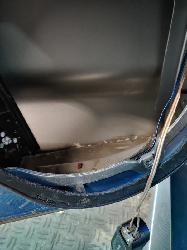

You can easily put any 6x9s of your choice in the doors.
All you have to do is gut the covers and use that to space out the speaker to clear the window track.
The door panel fits no problem.

Had my door panel off recently so here's some detail about using a gutted cover as the spacer to mount a 6x9 of your choice

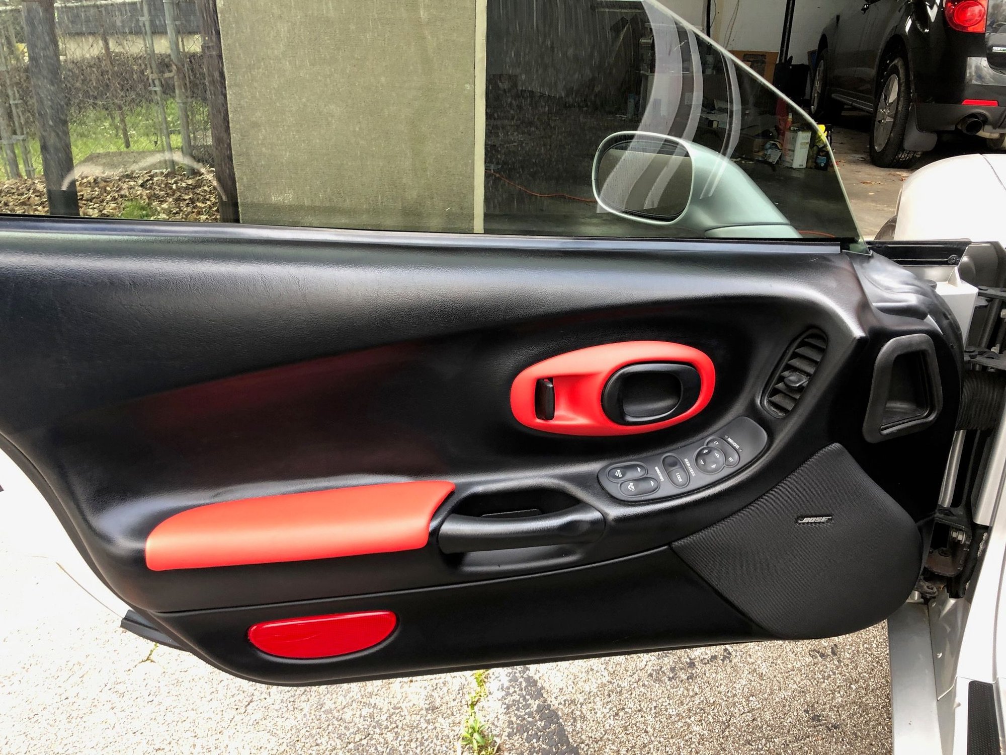

Just got the JBL GX302 and GX602 and installed them. They work great and the installed. Even took the opportunity to repaint all the grills, silicone the Bose logos down and even add a little dynamat behind the speakers. Came out great and sounds much better! Thanks for your help!
