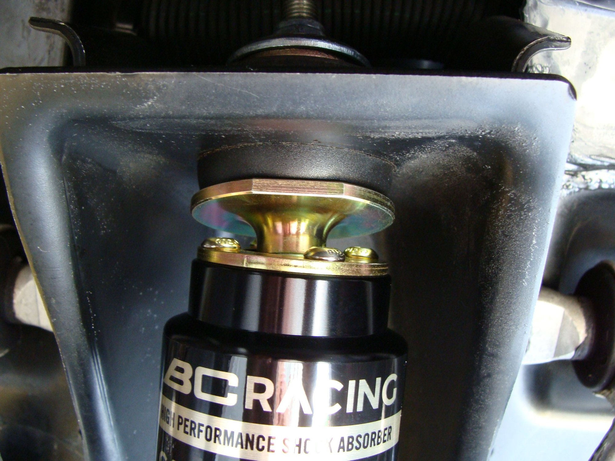

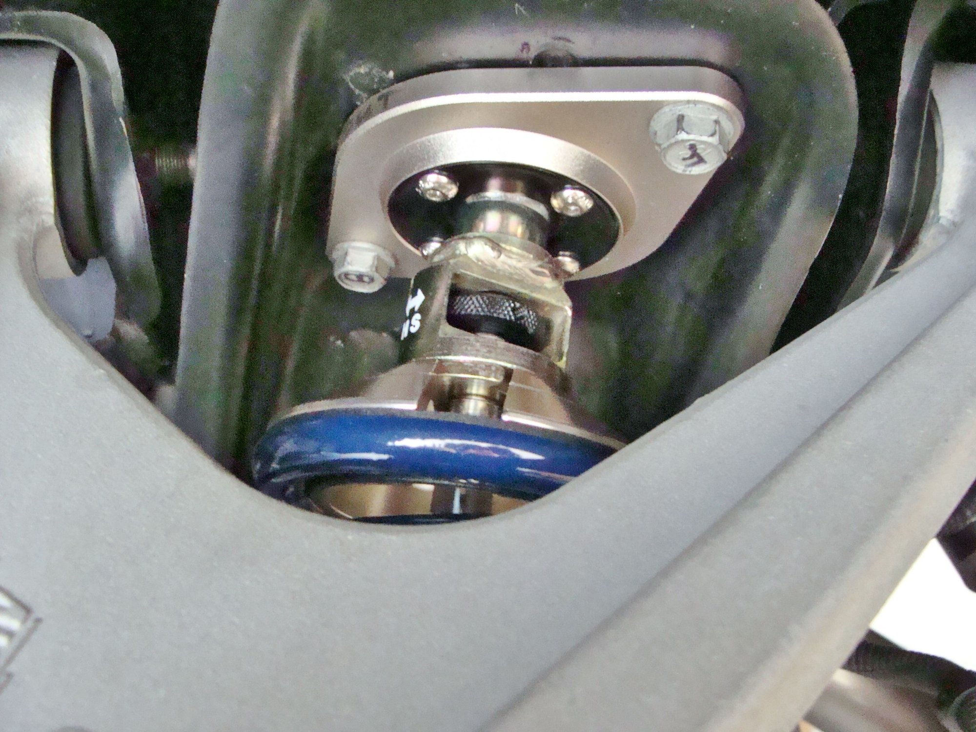

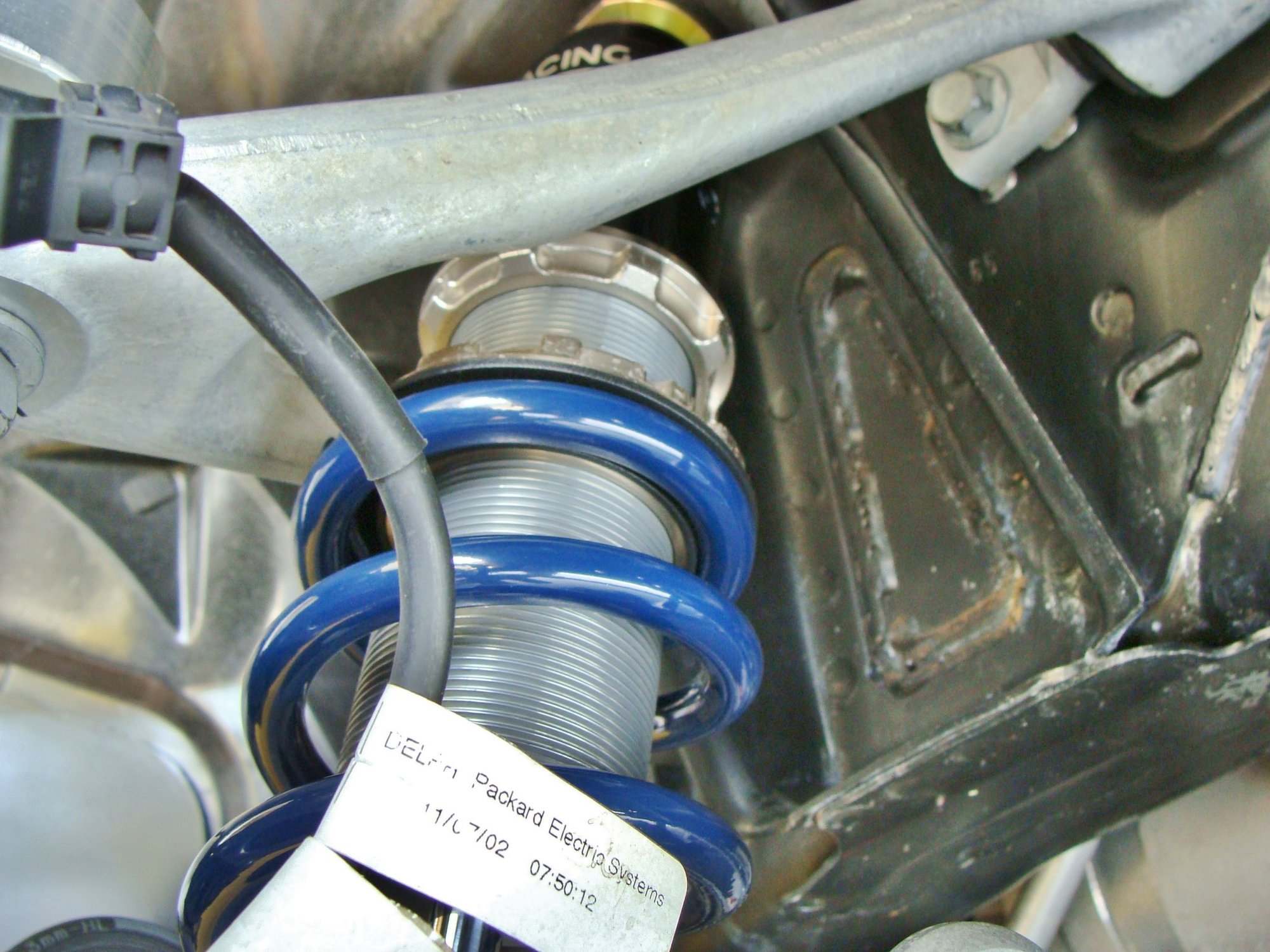

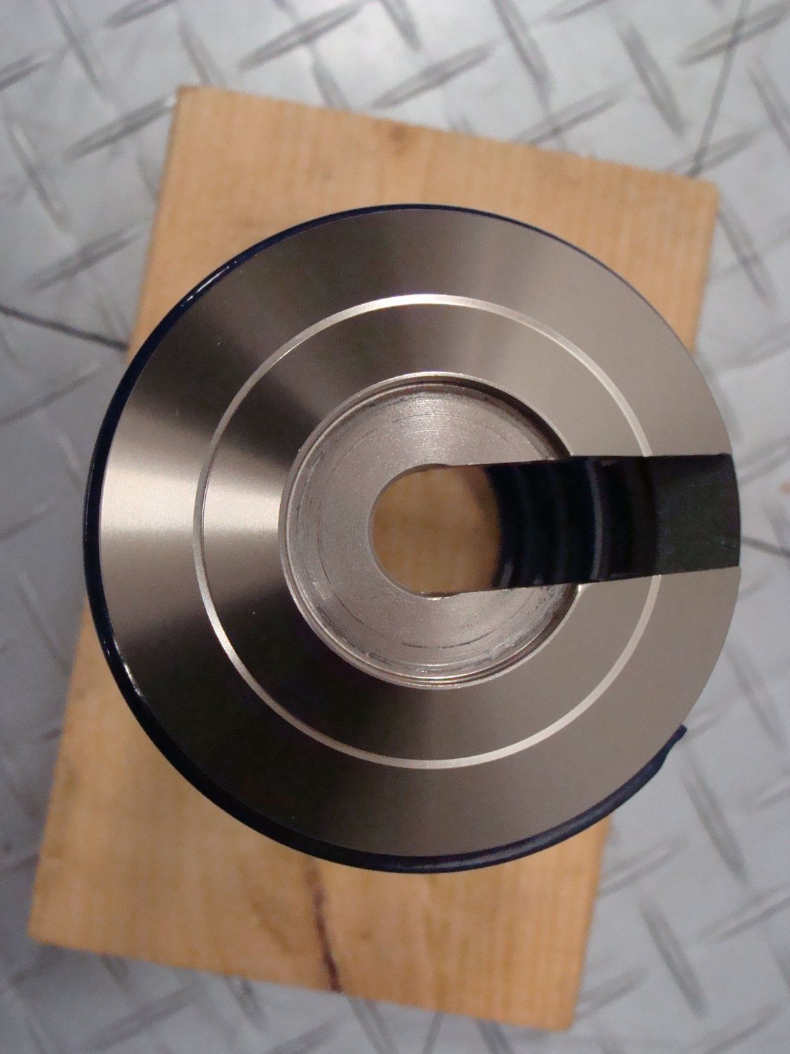

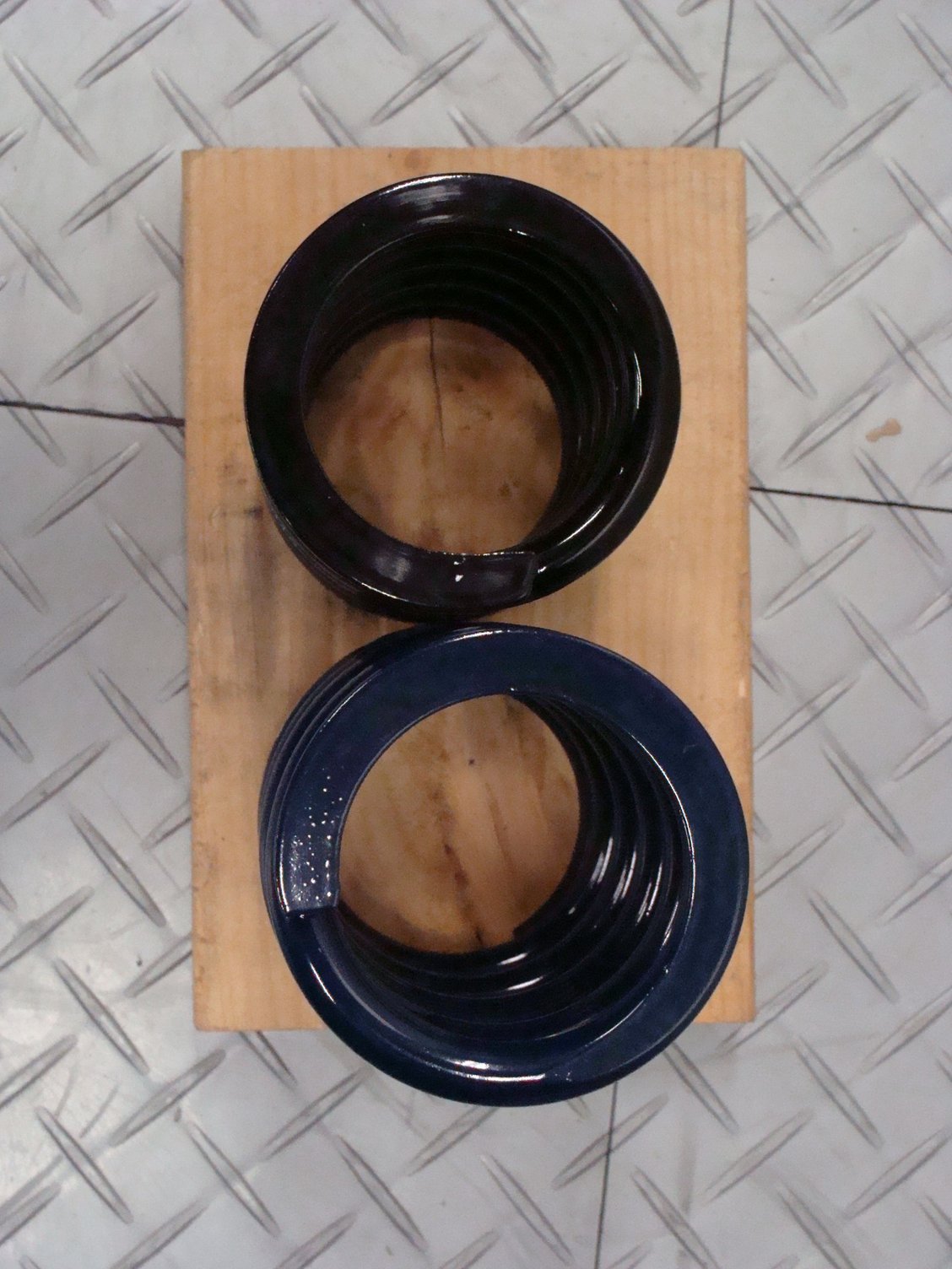

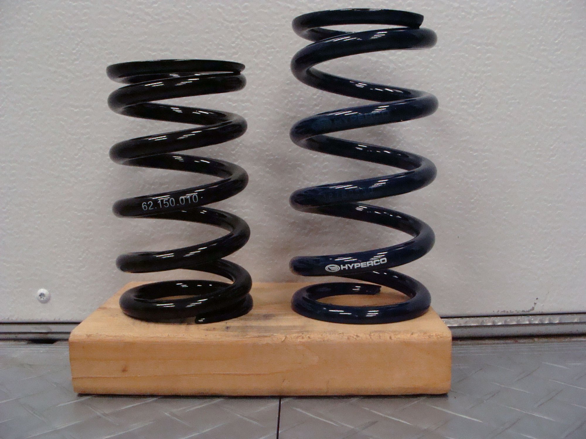

Pictures of the stock springs & Hyperco 7" springs, Hyperco recommended a longer spring for better ride & less stress on shock shaft.
Stock rubber bushing & poly bushing.

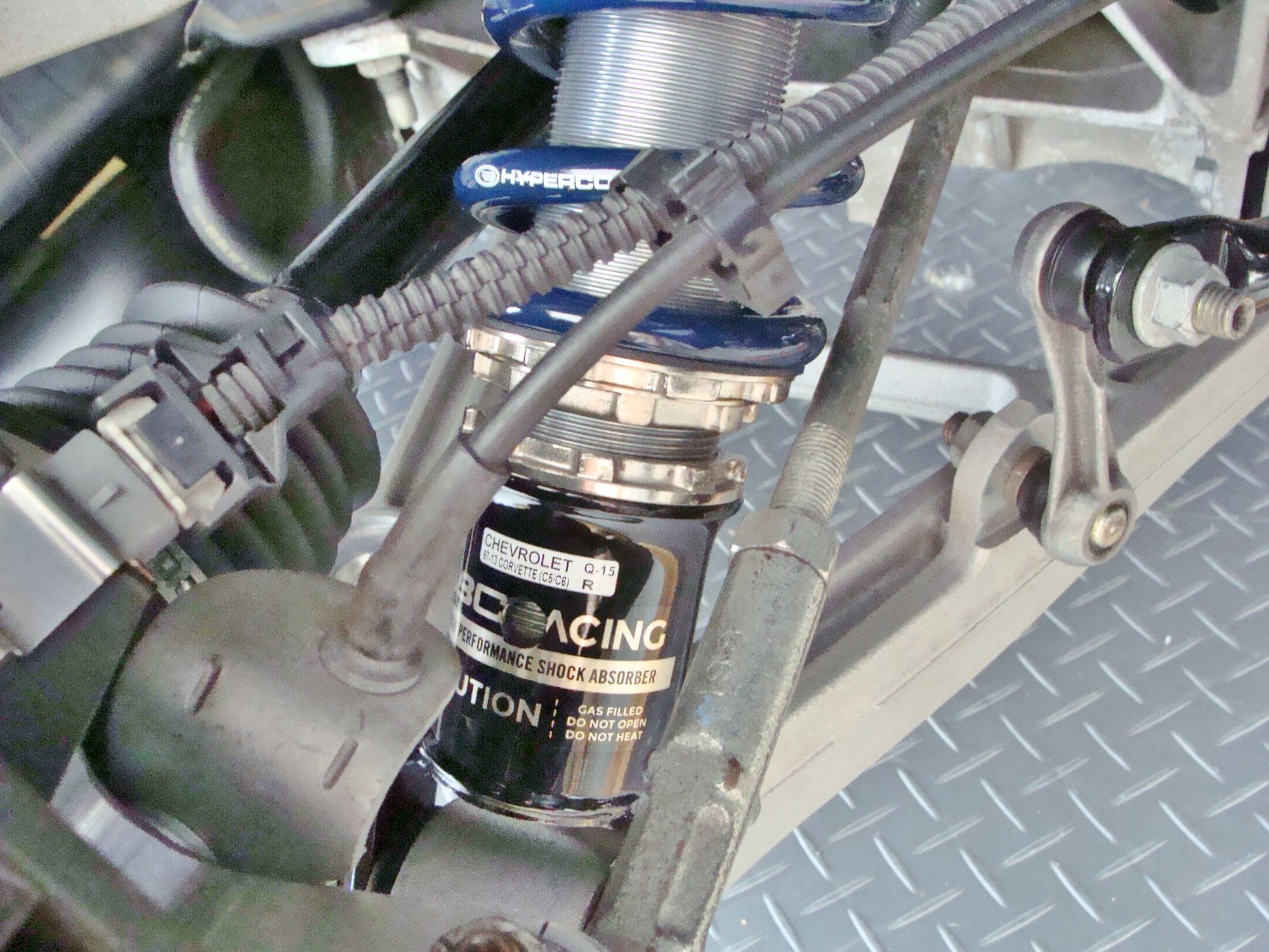

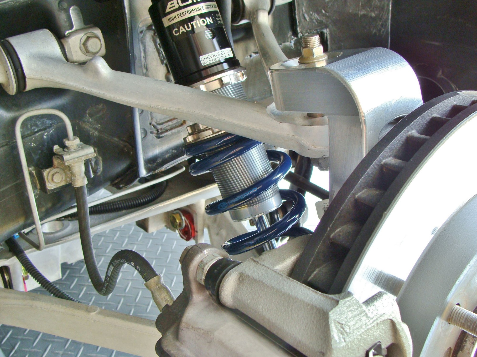

I marked my shock stroke 40/50/60% marks so I could set my stroke at 55-60% mark for more stroke on compression at ride height, just adjusted my preload to get close to my mark & then set my final ride height after.
No rubbing or scraping on any of the components after install, even with the longer & larger diameter springs, I can adjust my ride settings when the car is on the ground, do not have to raise the car to adjust.
Only install issue was the top front mount shaft the threads were what I would consider short, so I added extra washers I had from an extra sway bar end link set from my Chevelle so I could get my torque spec & not bottom out on the threads.

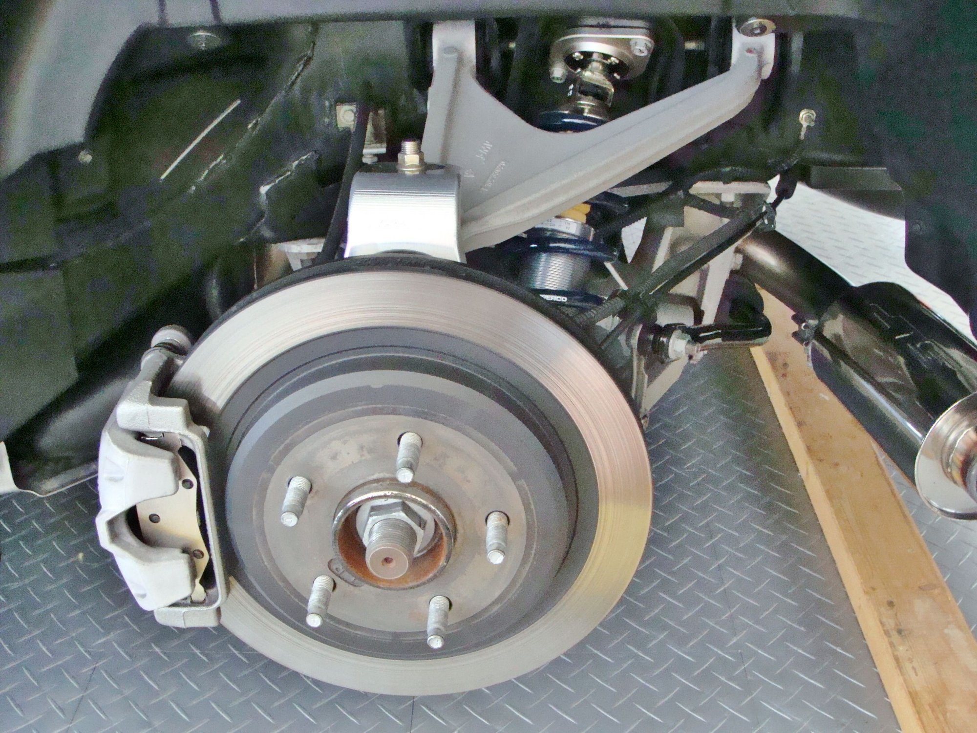

This pictures shows the extra washers I added on the top side of the shock tower on the upper poly shock bushing.
