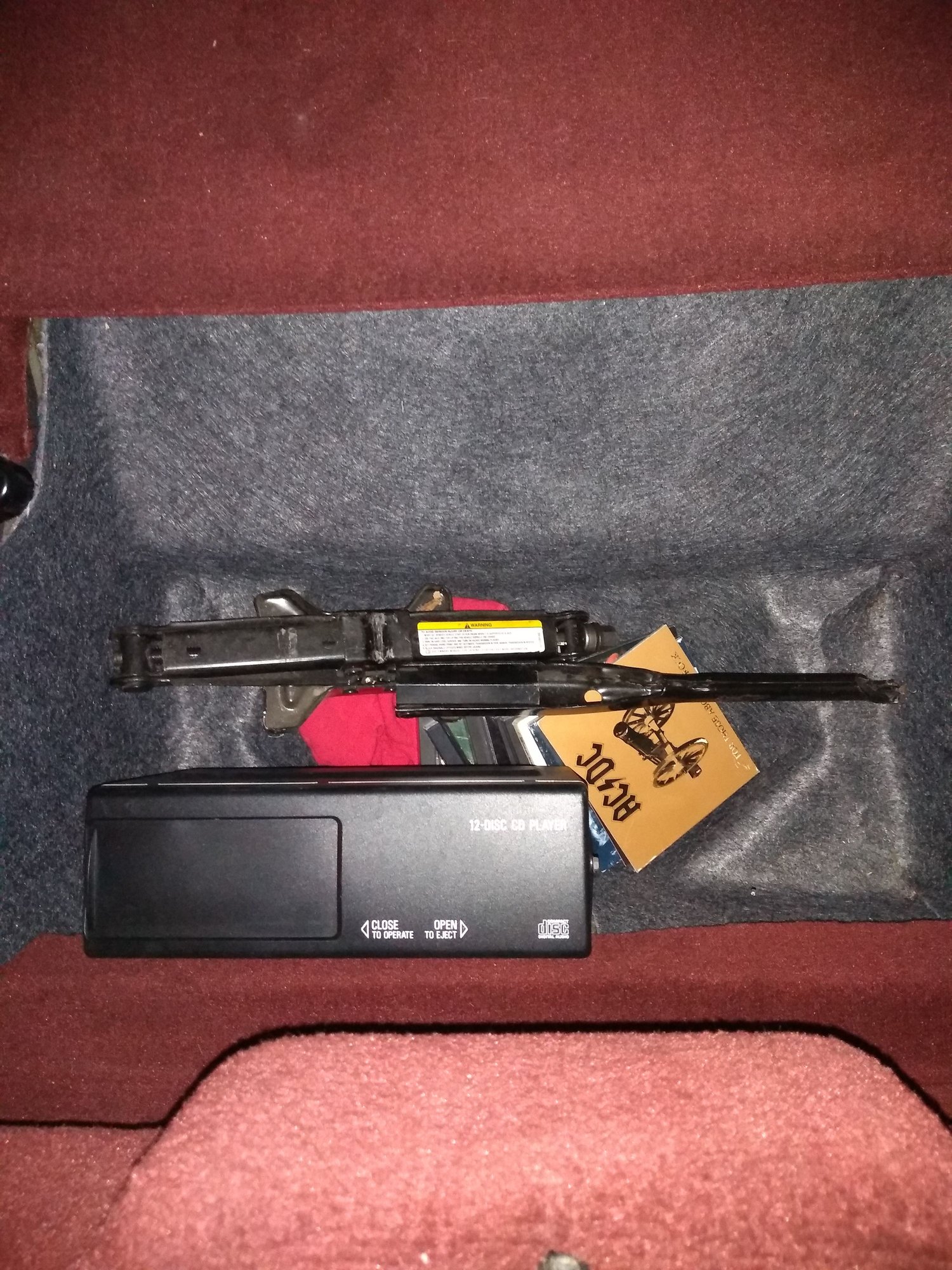

I bought 2 PT Cruiser Jack's at a self serve salvage yard, they were like 4 bucks each, the handle that spins the jack also is a lug wrench, honestly I forgot if it fits the C5 lug nuts.
Was going to let the air out of a tire and see if I could jack C5 with PT cruiser Jack and jacking puck, however I've procrastinated and this was if I go non run flats on next set of tires.
I have used the PT Cruiser jacks working on other cars in the driveway(breakjob on gf's car) because I didn't want to drag out floor jack (had to move stuff in garage to get to them, ) and they lift pretty quick and seem pretty stable, it looked like a PT cruiser Jack would fit into one of the storage things in C5.
I got the idea from someone else here on Corvette Forum.

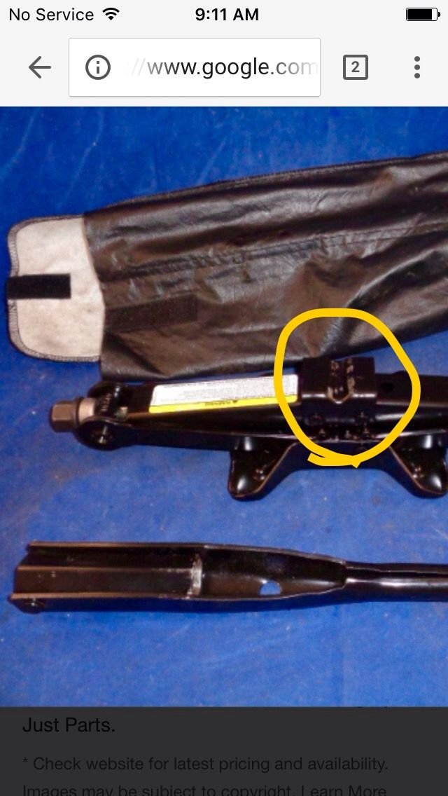

PT Cruiser Jack and handle/lug wrench.
I verified the lug wrench part fits my 1999 C5 wheel lock tool(same size as lug nuts)
Also remember, if the jack was too high to get under jacking puck, a small piece of wood like a 2 by 6 could carefully be driven onto by the flat tire to add clearance?
Have a good portable tire inflator, tire repair kit with those rubber rope plugs and tools to put it in hole, good chance it could get you back on the road.
Now I have never fixed a actual flat tire on a vehicle by putting in plugs, just put on spare tires, etc.
Tons of PT Cruiser cars at the junkyards to get the jack and handle/lug wrench from, should be cheap like 5 bucks max.

Actually I was just wondering if the PT Cruiser Jack lift point would be stable/safe with a lifting puck, because on regular cars you put it on the "lip" of sheet metal frame at the designated lift points, it has the groove in the lift point of jack?

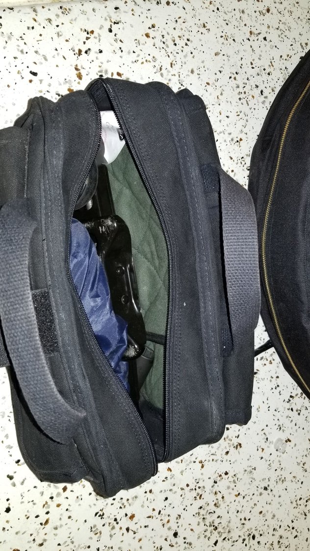

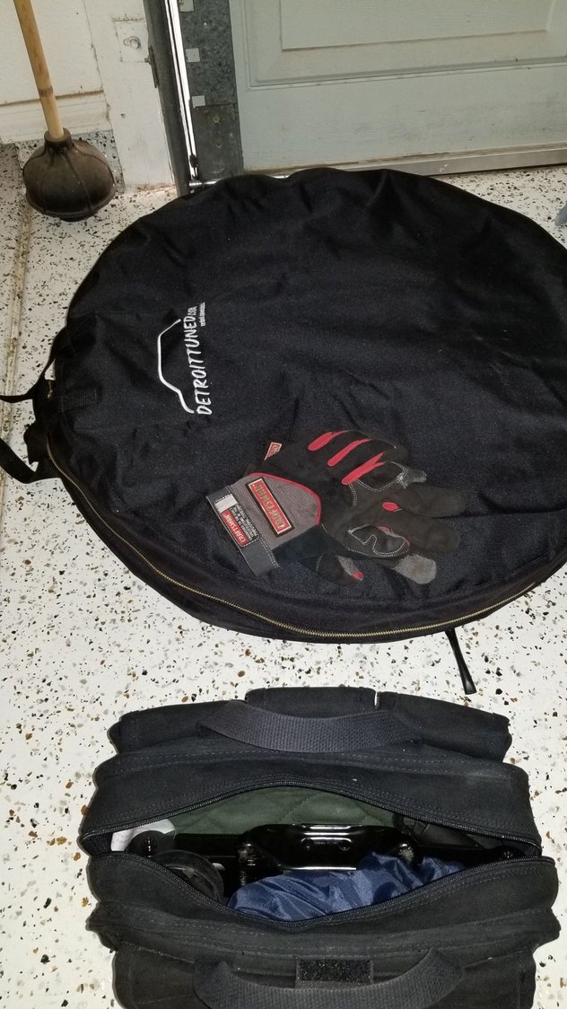

The PT Cruiser jack is perfectly stable on an aluminum lifting puck. I had at least an inch under it on a completely deflated tire (Stock ride height Z06) and changed the tire completely using only the tools I carry. I chose to replace the PT Cruiser lug wrench with an old 15" Craftsman Breaker bar and 19mm deep socket. I carry the jack, the breaker and the lifting pucks in an old small padded gun bag I had.

The complete setup.
