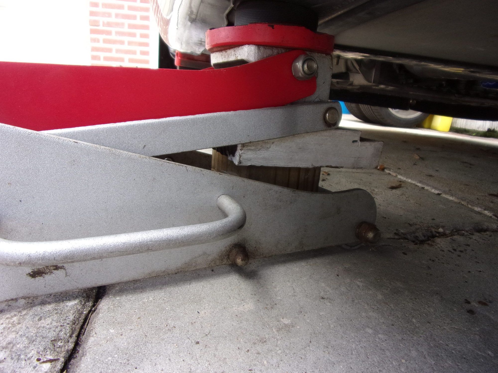

This is an old post, but the recent replies got my interest. First time ever for having to jack the car up. I resolved the jack/jack stand "challenge" by placing appropriate 4X4 and 2X4 under the floor jack lifting points. The hydraulic jack would naturally bleed down after a while (as compared to a scissors jack) . Next time around I will cut 4X4 to desired height instead of using two blocks. BTW, the rigidity of the frame was very impressive when lifted in just one corner!
