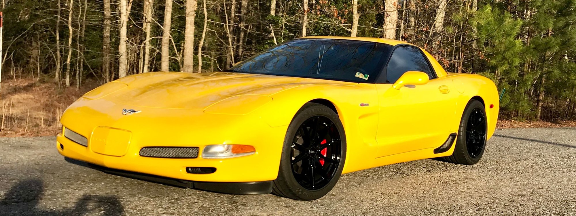

I run 295/35R18’s on 18x10.5 rims on all four corners on a 2003 Z. I track the car and run it on the street in a ‘spirited’ manner at times. No issues whatsoever with TC or AH. The car feels much more planted and handles like it’s on rails.
