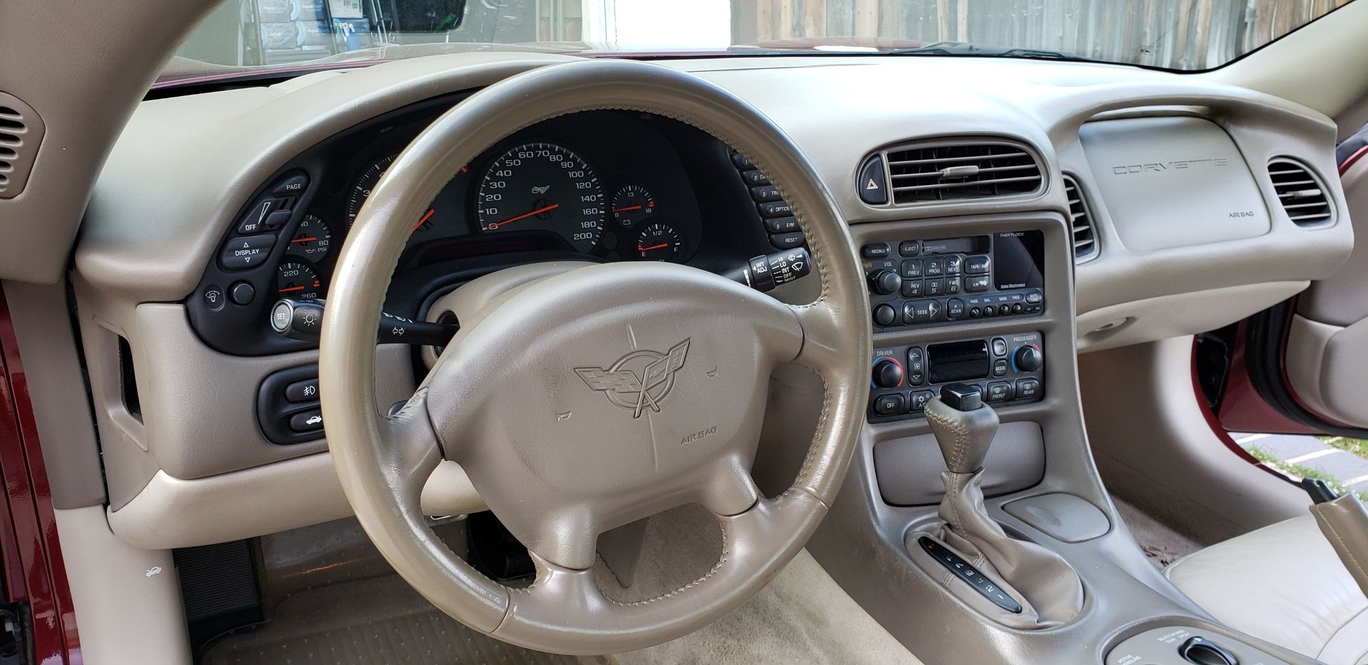

I couldn't find anything on this. So I apologize if this has been addressed before.
I have a 2003 50th Anniversary Edition what are the colors of the interior? Shale I
know is one of the colors. Is that the seats/bottom section? What is the darker tan/brownish
color called? I'm looking for some spray dye to freshen up the darker section. Also if I
decide to do a stereo swap I would order the bezel and paint it to match the car. Any good
leads on said dye would be awesome. Any help would be greatly appreciated.
Larney

Ok found all the codes in my glove box. The only clue if you will was the code 151= Interior trim Shale(50th Anniversary).
and 154= Trim Combinations Leather, Shale (50th Anniversary). So I'm still at the same question regardless of paint sticking
or not. What is the second(upper) color? Could it possibly be called Oak? The color is darker than the dash picture indicates.
More like the upper door panel.

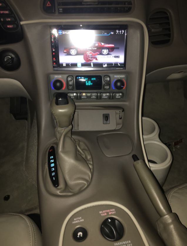

I painted a new black Vettenuts DD bezel with Medium Dark Neutral, followed by several Matte clear coats (after I initially prepped it with an adhesion promoter). I also painted the black cupholders on the side with Shale in the same method. Both turned out fine IMO.

Thank you so much. That is exactly what I needed....
