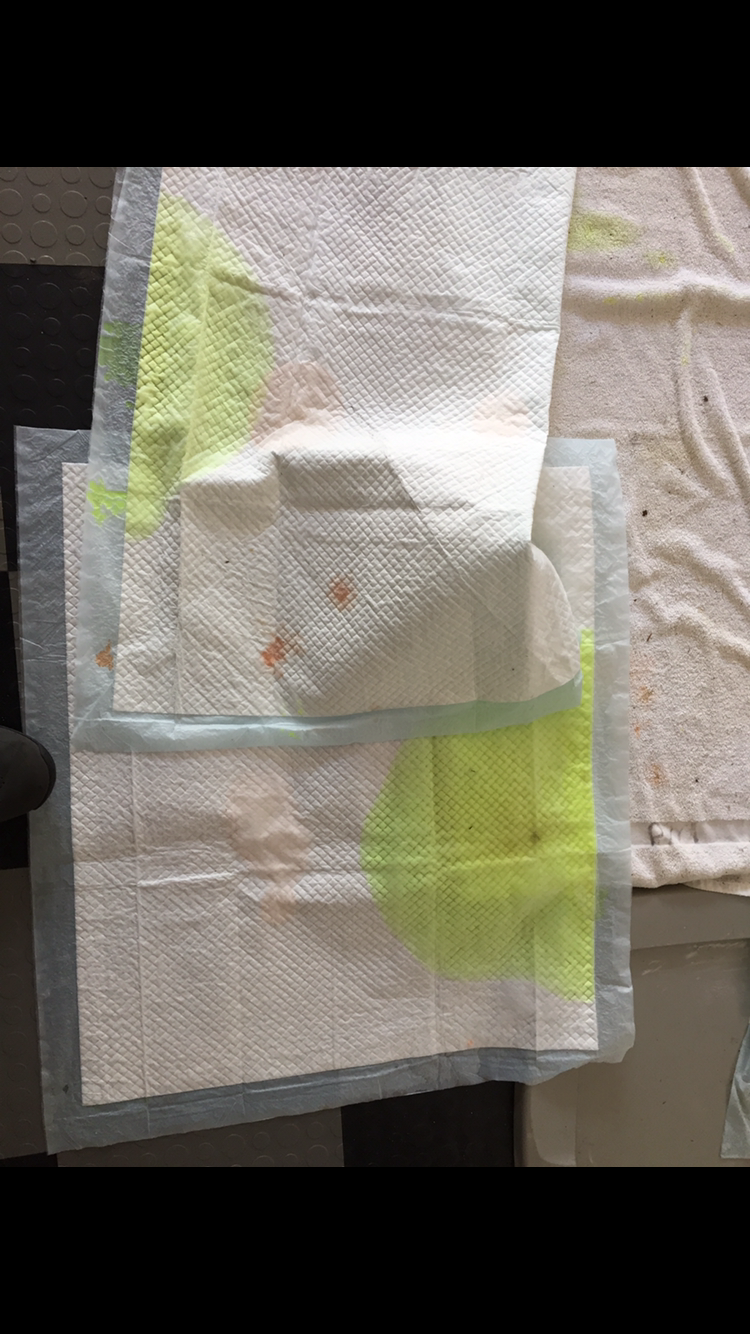

Looks like lime green to me on passenger side what could it be

Most likely, antifreeze.

It also started doing it after I recharged sc last year that’s when it started

Recharged ac

If it's not coolant, maybe it's the dye in the freon to check for leaks. Get a good light or U/V light and look for where it might be coming out of the A/C system..

Looks too bright for antifreeze to me.

If it was coolant wouldn’t the car overheat I’ll check the ac lines also thanks

If he has stock GM fill of Dexcool, it's Red, so It's not Antifreeze/coolant.
My guess, like JR-01 said, is it's Freon dye. might want to check for leaks. They make a light kit that pics up that dye, which is really just a black light.

Where can I get the light and does the ac have to be on when checking it
Search internet for light & yes the AC needs to be on
