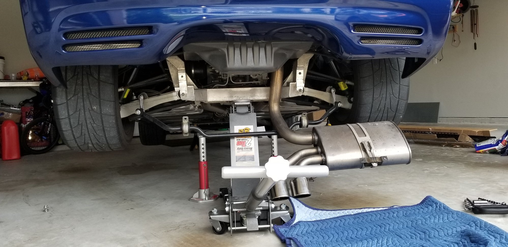

I can easily swap my exhaust out with just a jack and jack stands in the garage. I picked up the highest lift low profile jack from Harbor Freight which has a max lift of 24". Put the font of the car on jack stands so the nose doesn't hit the ground and use a moving blanket to protect the exhaust tips since they do get close to the ground. Of course always be careful with the car up this high.

Thanks for the photo, but that makes me cringe.
