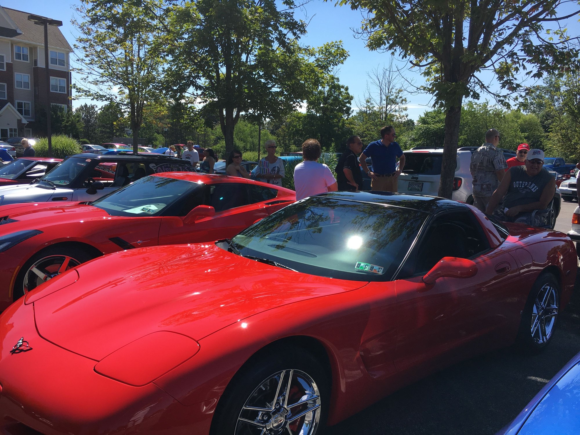

Who's looking at the rotors when their on a car that looks like this. That rotor was installed in 2007, not to bad for its age. By the way are you trying to hide your car behind a set to pretty rotors.
