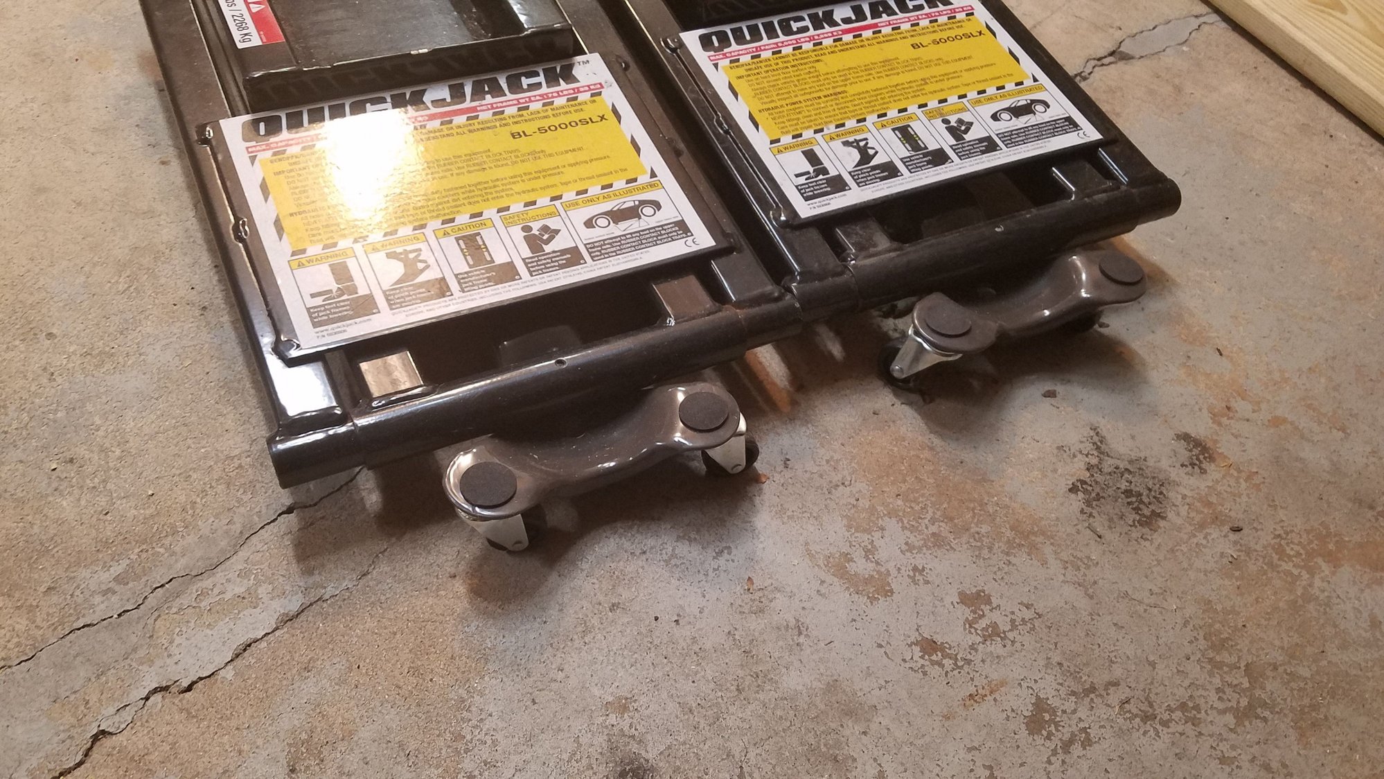

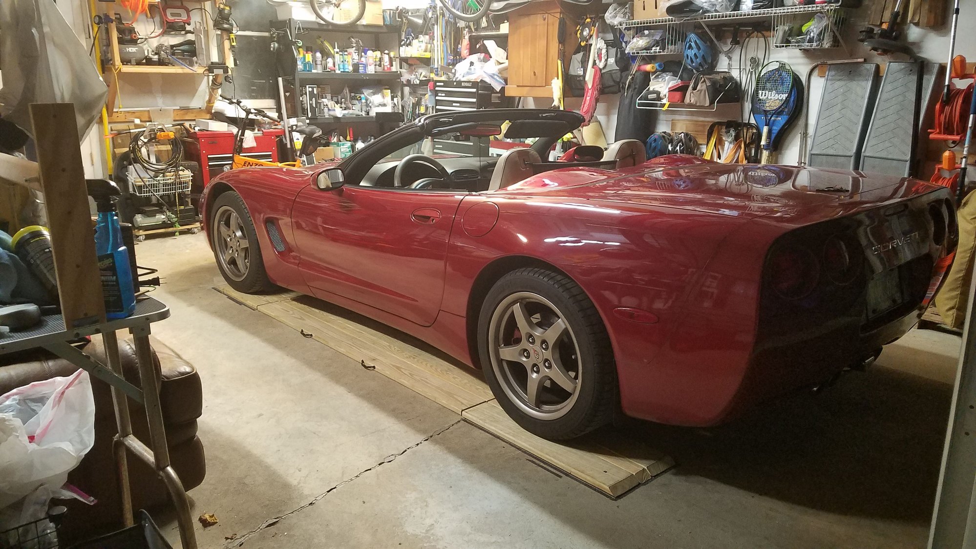

To recess them into the floor and be able to drive over them would require they be deep enough that you could also have a cover capable of supporting the weight of the car while you drive over it. You would then lose several inches of lifting height. I keep mine on the floor and drive the Corvette over them and just pull them out from under to the sides when I need to lift the car. The C5 cleared them easily; however, I found them difficult to slide along the floor - concrete floor that is fairly rough. So I put the ends onto little three-wheel dollies. This lifted them up enough that I had to create a very slight ramp system for the car to drive up on. Now it works like a charm.
