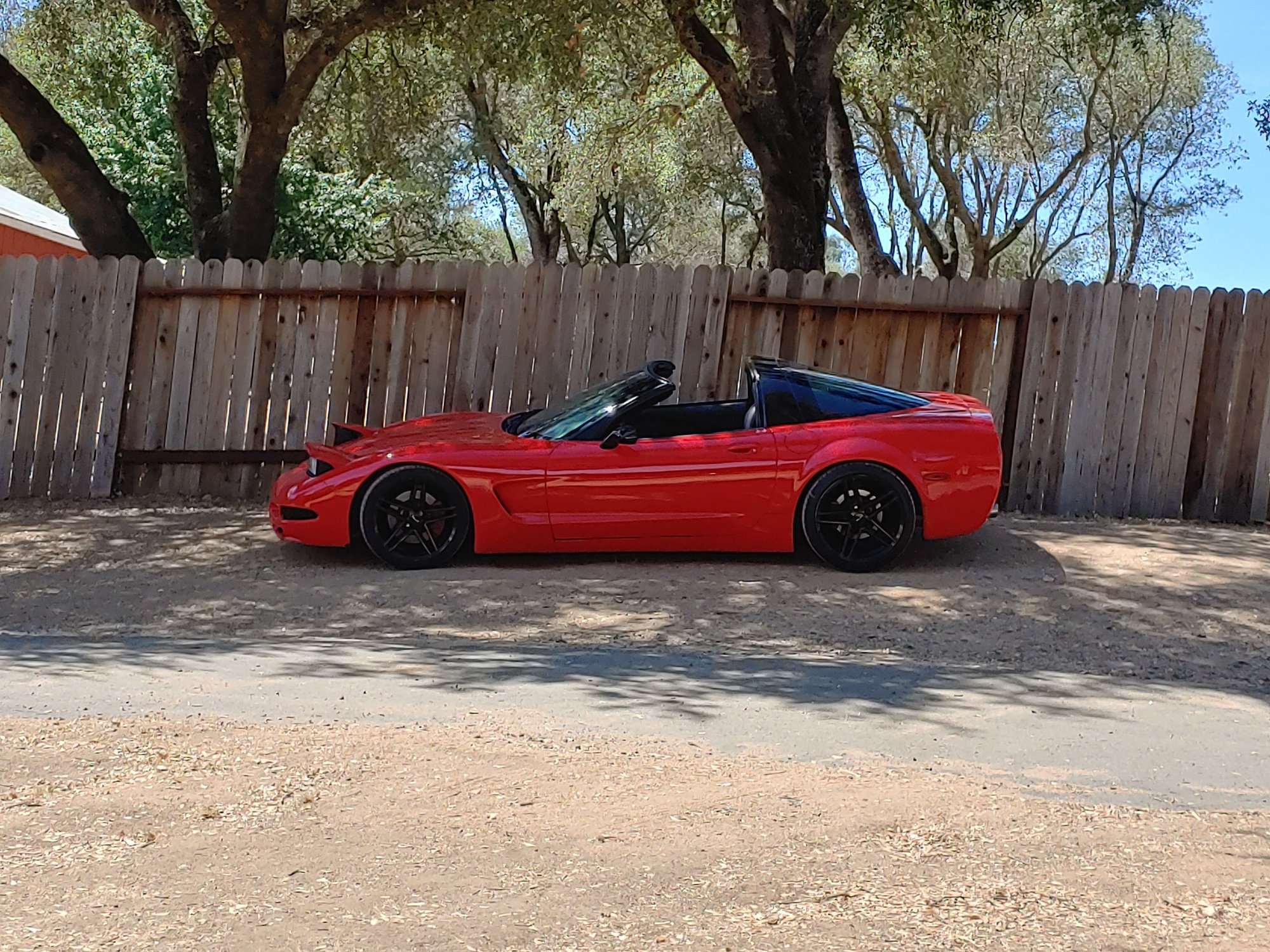

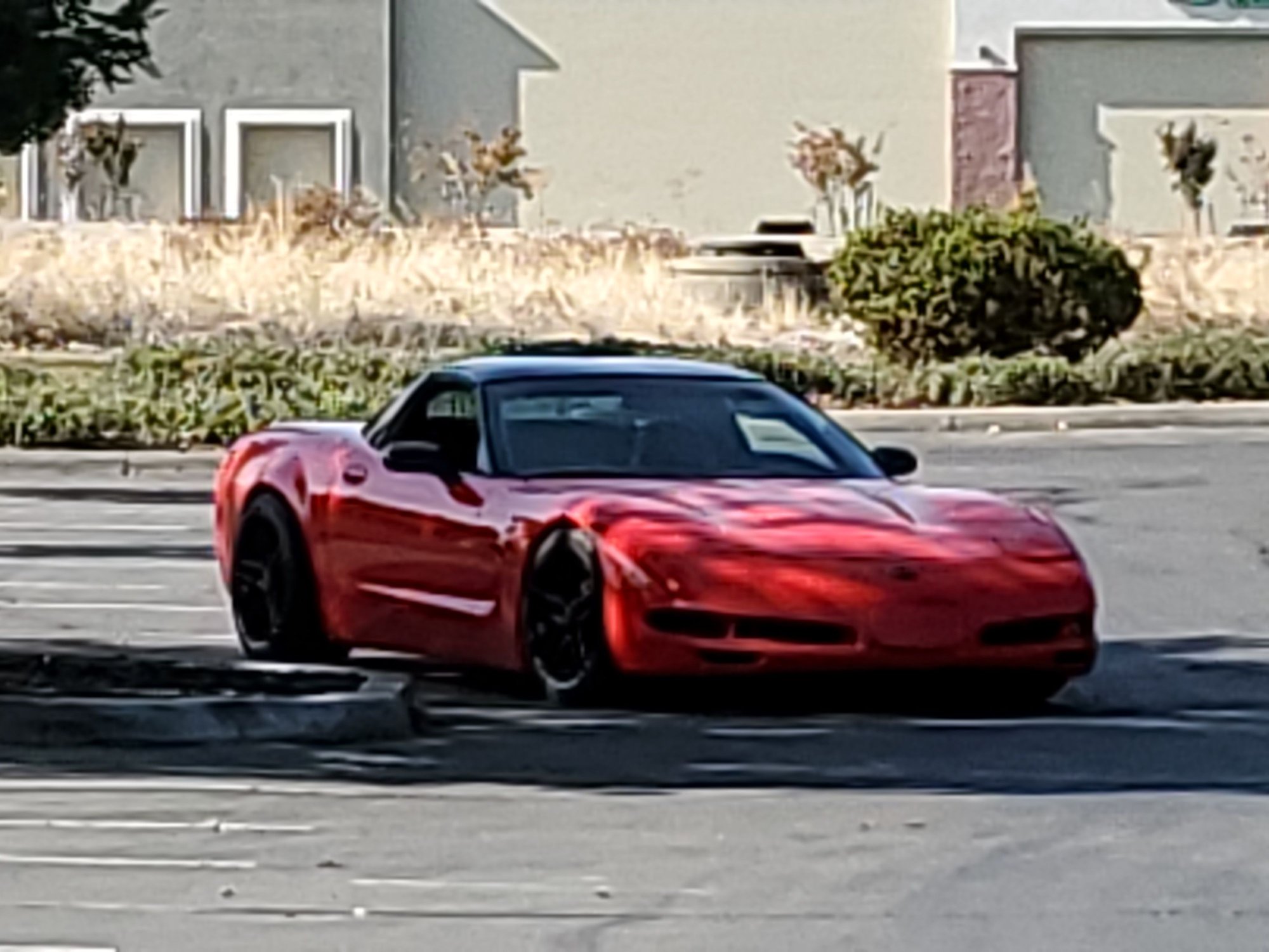

Hey everybody,
I have an 04 c5,
not a lot of info on motor,
I know it has a cam from Texas Speed,long tube headers,and that's it.
I believe it has the stock heads and will know for sure by next weekend.
The car is strong,cam is somewhat aggressive and same in lope.
I'm looking for a cam/head package to put car around 500 hp.

well seeing as your in California I’d talk to the folks at A&A Corvette, their entry level kits are capable of 500whp on an otherwise stock C5. With the mods you have already I’d think 550whp would be plausible. By the way you have a fantastic looking C5! 🤙🏼😊
