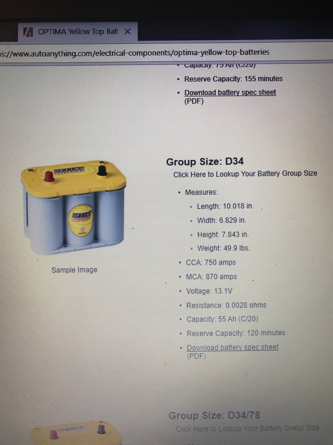

I bought this one I hope it’s right?
Old Mar 11, 2020 | 10:09 PM
knewblewkorvette's Avatar
knewblewkorvette
Joined: May 2003
Posts: 14,137
Likes: 2,985
From: Iowa
Yup
