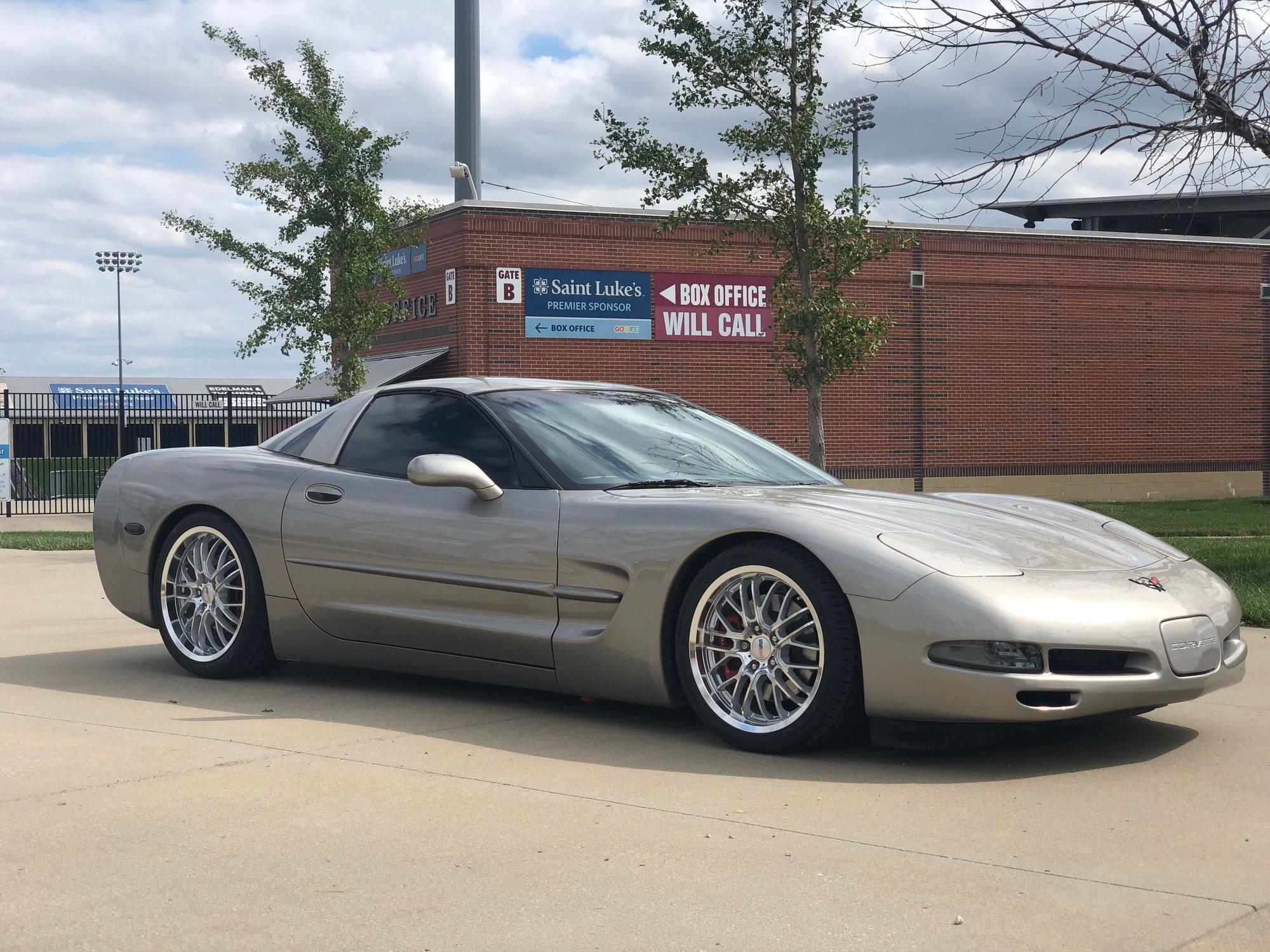

Perfect. I’ve got mine dropped on aftermarket bolts and I’ve been worried about dragging the headers off
looks sharp! The lg headers come with an x pipe, the streets have 2 1/2” and the pro’s are 3”

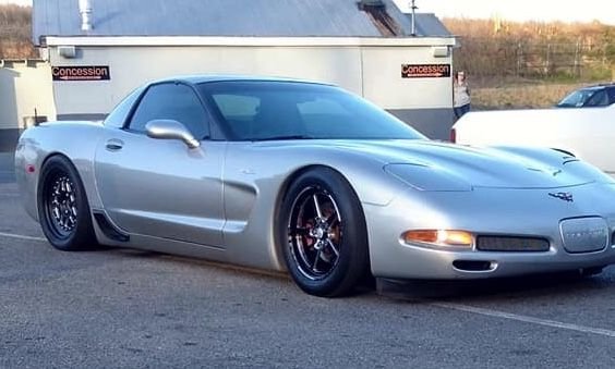

Nice stance and wheels! Whats your wheel setup?

Thanks, 17x11 bogart d10’s on back and weld alumastar on front
