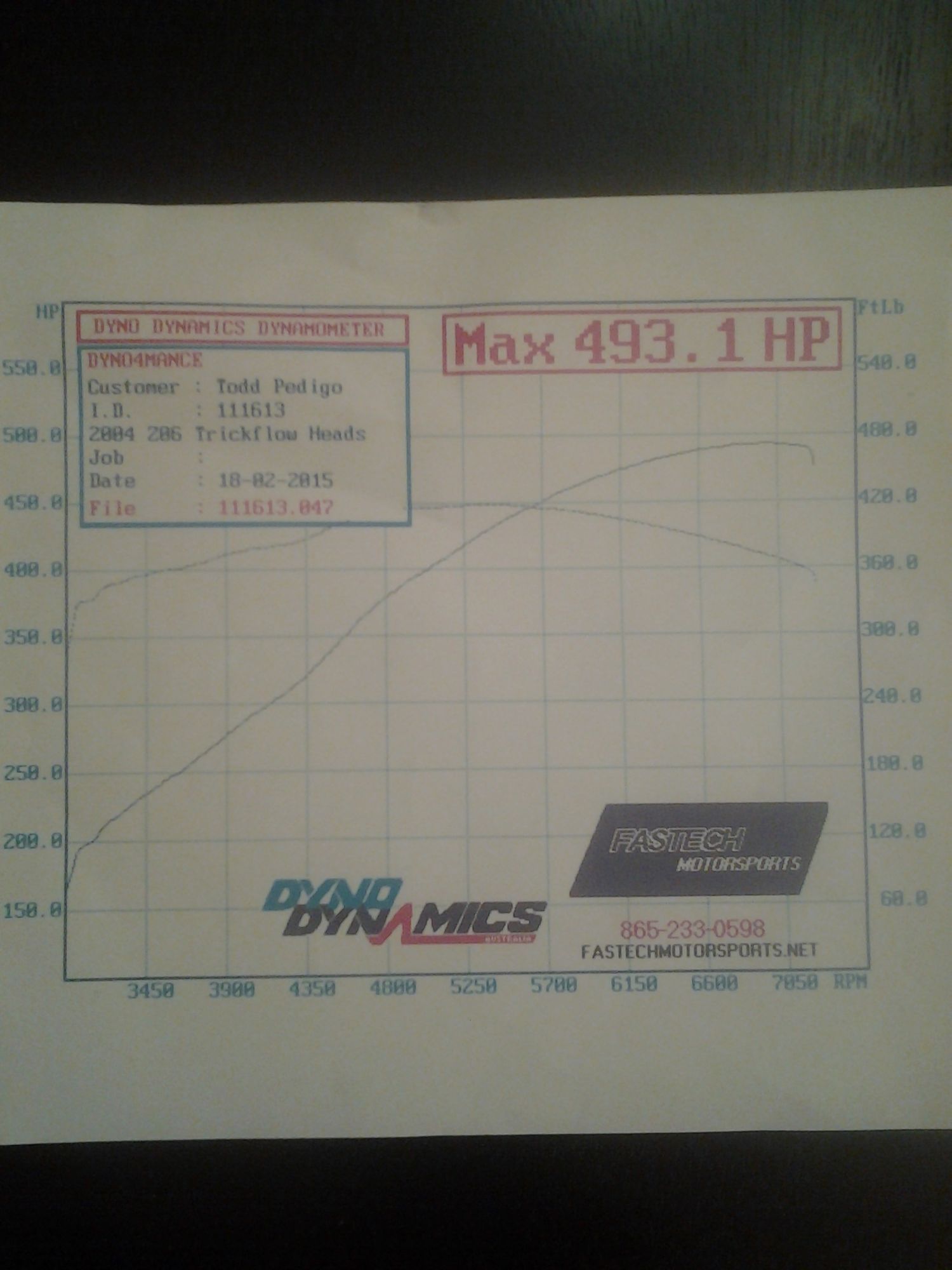

You don’t see it because most people don’t see the importance of running high compression around 11:8-12:1 out of these motors to get the most power, along with the right cam and quench, this is easily done on 93 octane
this was my first build, very basic build
on a dyno dynamics dyno
tfs 215’s
.045 gasket
fast 102
g5x2 cam
lg street headers
stock 3.42

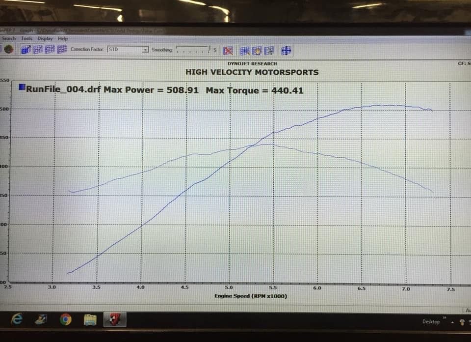

This is current but with several 100 1/8 mile passes on it so it’s been beat on
same heads
g5x3 cam
more compression
ewp, vacuum pump
msd atomic intake
lg pro’s
4.10’s
different dyno
