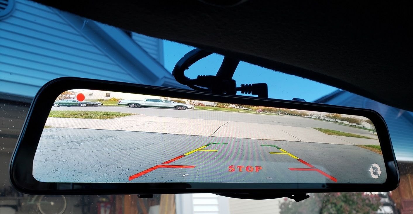

In my 04 Z06 I have the VanTop H612T w/direct wire camera. It works great as both front/rear dashcams and it changes to BU camera mode when put into reverse.
Here is a test vid I made (showing only dash cams in 2k mode)
Here is a vid showing 4K front and 1080P rear
Rear camera mode

I like your setup. But will it plug and play with any year C5, or just the later models with the Home/garage door opener system, or??? Thank you. Your install looks like a factory install!!
Mine is the updated version of the other post ( https://www.corvetteforum.com/forums...lled-pics.html )
As-is it straps over the old mirror. So what I've done is buy an old mirror and this winter I pan to strip off the mirror and its housing. But use the ball / socket and lights to make a cleaner install.

I have heard it suggested that you retain the stock mirror and install the added mirror camera down lower on the dash. I'm thinking about it. I'm not sure how the front camera would work that low above the long hood.
I just purchased the Vantop H612T so I will see how it goes.
Old May 17, 2021 | 06:50 PM
sd45t2's Avatar
sd45t2
Joined: May 2020
Posts: 265
Likes: 128
From: San Antonio, Texas
My extra windshield mirror comes tomorrow. More on the final installation after that.
It seems to me that the stock Corvette mirror, like any mirror, allows you a depth of field so you can focus on objects at a distance behind you.
This camera, or any similar camera, is like a picture in front of you. It has no depth of field. Thus what you see in the camera presentation requires an 18 to 24 inch focus. I've decided that is what confused me a little as I used the camera for the first time.
So this new set up with the Zantop placed lower on the dash and the regular mirror still available will give me the best of both displays.
I will add that this Zantop display was fantastic! Better than my big screen TV. So very, very clear and detailed.
BTW, the wire connections at the top of the mirror became very warm when it was mounted on the regular 2013 GS mirror.
