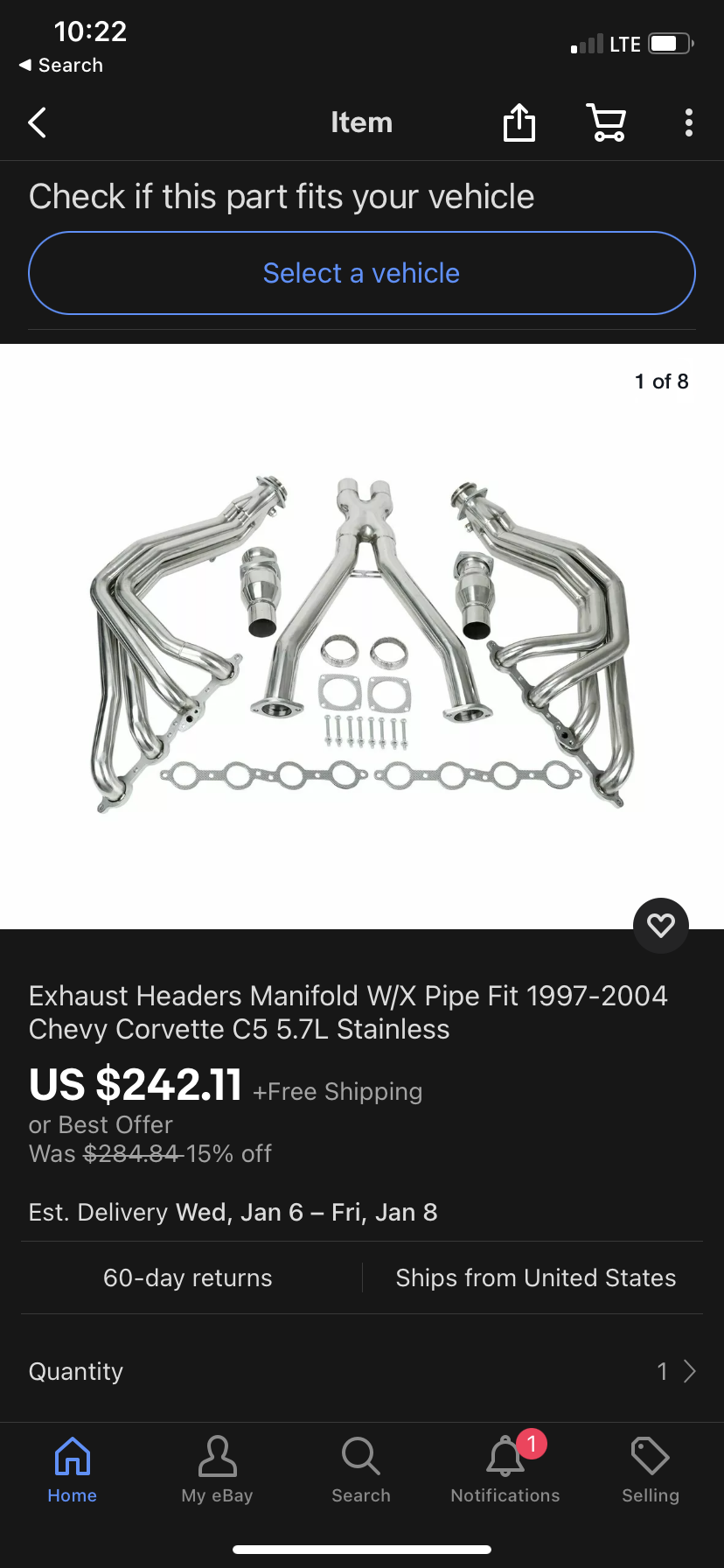

I had a surprise engine rebuild and have spent way more money than I should so I was wondering if anyone has experience with the cheap headers and x pipes on ebay. Do they fit well? Sound good? Etc
thanks

Cheap ain't good and good ain't cheap.
Speed Engineering and XS-power seem to be the most popular cheap header kits.
I am using the Speed Engineering headers and am very pleased with their fitment and performance, To be fair I did convert the collectors to vband flanges.
I would not buy a random 200 dollar ebay kit but that is just me.

I've got a set of headers off of amazon on my car right now and they pretty much look the same as you've pictured. We encountered two minor issues.
1. The mounting tabs on the collectors didn't line up to the mounting points on the car. We solved this by cutting off those tabs and welding on a piece of metal to each one that would line up with the factory mounting locations on the body. The rear mounts are spring-loaded, so there's enough give in them to handle minor differences.
2. The bungs for the O2 sensors put the sensors at such an angle that the heat shield needed a hole cut into it for them to sit right.
We didn't have any issues with steering shaft clearance, floor clearance, or ground clearance. I'm happy to have spent the $1000 I saved over brand name headers on the heads cam that went in at the same time. Don't pay the Corvette tax on a 20 year old car if you don't have to.
Where are you in GA? I'll come show you what mine look like on the car if you're close to the north side of Atlanta.
