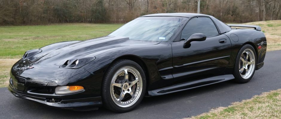

Just picked this puppy up.
1998 LPE .42k on clock.
Been stored as a semi collection .Runs like a beast All N/A built motor ,Trans and suspension by Lingenfelter built .
Only issue so far is the A/C .And waiting for my meats /or tires.

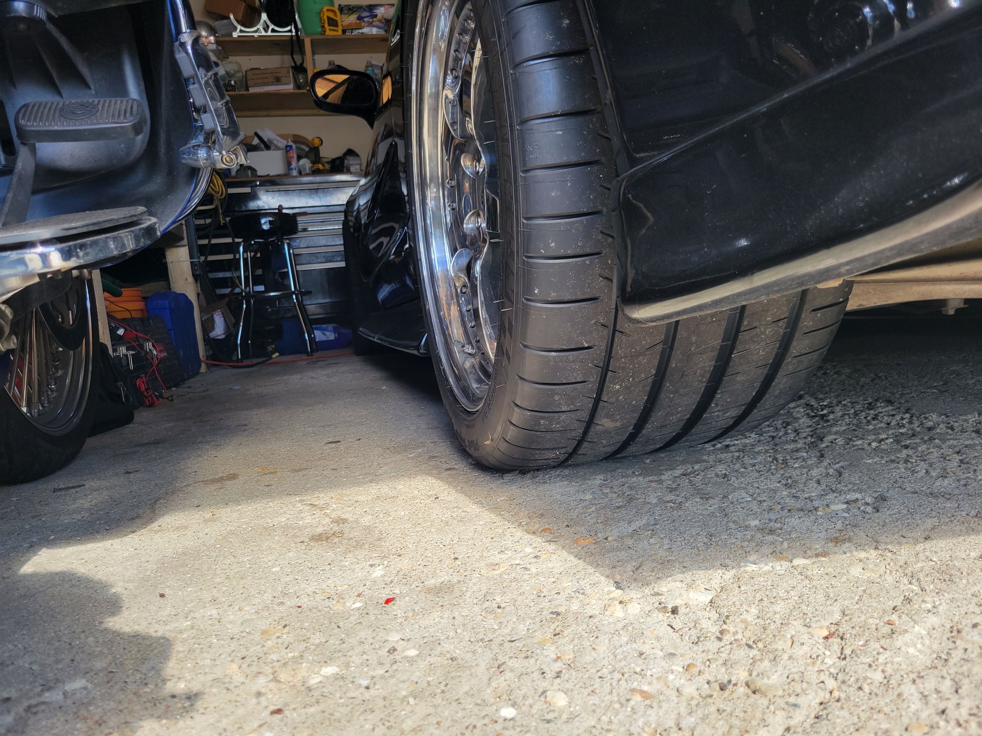

Waiting on discount tire to get my tires in .This thing is tubbedd and has 345/30/19 on back of it 😁

285/35/18 fronts 345/30/19 rears
