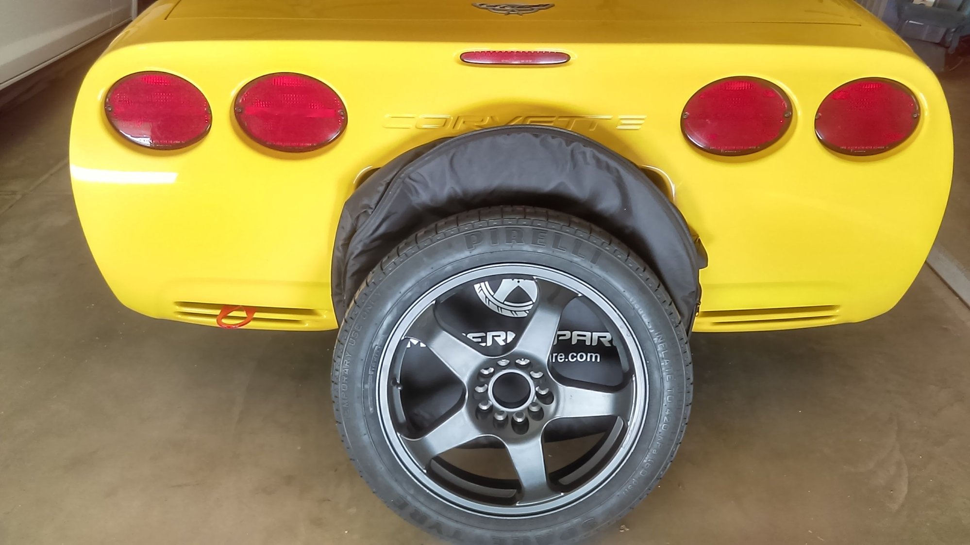

Check out Modernspare.com. Spare tire and kit for our Vettes.
That looks fantastic!
But I agree with the others. My 01 had a compressor, tire kit, pliers, a matt, and a modified Mercedes aluminum scissors jack. In 11 years I never had a flat tire for any reason.
